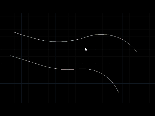

Draw slope lines
ghostware
I wrote something similar in VBA. I used "intersectwith" method but had a problem with embankment with curvature bigger than 90deg. (I know what problem it is and how to solve it but don't have time to wrote it ;/) does it work in yours code?
...and what will happen if bottom slope will be shorter than upper? ;)

i cant use this lsp on my map 3d 2010. i try with 2 pline (and 2 spline), but i cant. im taking this report "; error: no function definition: VLAX-ENAME->VLA-OBJECT"
Pls Help Me!!
Pls Help Me!!
add (vl-load-com) to the top of the code.
Thanks, nice lisp!
Seems to work slowly with big splines...why?
Excellent. For my use afstand changed the variable to a real value.
Allows greater freedom in the scale factor.
It is much like another routine dtal.vlx
(setq afstand (getreal "\ nLine slope distance:"))

Here is my revision... Fixed bug with splines - it should finish routine; you shouldn't finish it when hitting ESC... Now is OK...

Hi,
What should be changed in slope-line.lsp to have the second tick 30% in length of the first one not 50%.
thanks!
Look into red comment :
