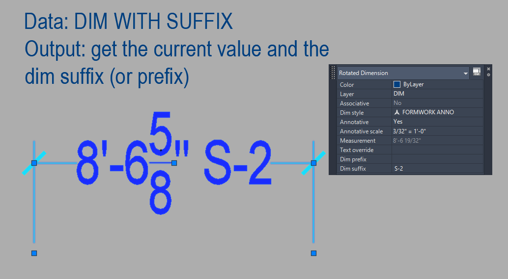

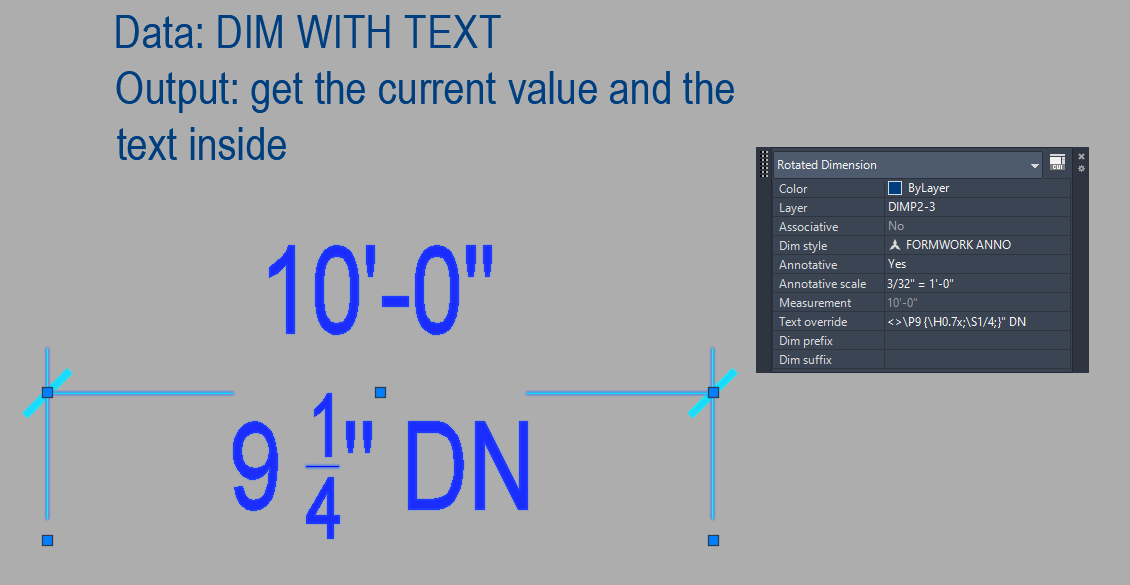

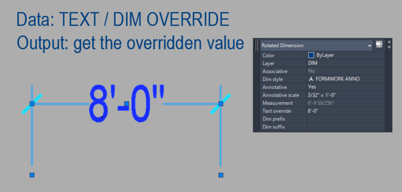

Hi Lee Mac,
I was looking for a lisp like this. On my job I have to set different suffix/prefix or codes by overriding or addin text into the dimensions. So, I have a couple
of questions:
1. Is tehere a way to also obtain the prefix and sufix of the selected dimensions?
2. Is it possible to get the overrided dimensions/text?
thanks in advance!
 1183573266_overriddeninformation.thumb.png.7f26960f618b27a0b69a22e378ec887d.png1555014661_dimsuffix.thumb.png.e7822b054317f8083fdadba40cf21868.png1524455991_realvalueplusdata.thumb.png.2dc872cd41c2ff738b0721feec6936b7.png

Try this and look at code ( 1. xxx)   (entget (car (entsel "\nPick dim")))
You will see the <> in the dxf group (1 . this means use the value based on the dim points, if you fully overide the <> will not be there. You can see that in your dim string for the 3rd example. So pre<> is a prefix <>suf is a suffix. Yes could do a look into the dim text string and work out what type it is.
So when you say can you GET what you want, what to do with result make a file, make a table etc  ?
