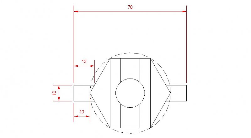

wheel drawing in A9Tech
Top view? Do you mean the cut-away section? Normally you do not draw that until after drawing the plan view.
A9Tech is an IntelliCAD based program. It should definitely have a way to construct a polygon. Look in the Help file.

I do not agree with the way the two holes on the right are shown in the 3D version GeoBuilder posted back on 19th Apr 2010. Look at the 2D (length-wise) section and you'll see what I mean.
Yes, you're right, I forgot to cut the lower larger diameter
On Monday I will be at work to do :)
No problem. It is easy to overlook. Thanks.

No Polygon command and they still have the nerve to call it a CAD program? No wonder why it is free.
OK. So here is what you do. Draw the polygon yourself. Each side will be 25.00 units long and the angle between any two sides will be 120 degrees. You can do that can't you? Remember it is 6-sided and should fit inside a circle with the diameter of 50.00 units.
its hard to understand newbies with this a9tech.only command prompts are helpful to draw anything.I searched in this forum and got hints to draw a line at degrees.http://www.cadtutor.net/forum/showthread.php?t=7356
only easy solution for drawing looks autocad
I have drawn that polygon and line but i need those two lines to draw which are in blue color in the below image.I will continue on this diagram untill i finish.I have spended more time to search for polygon but no answer for a9tech.It looks they may have command or it may be in pro version :roll:
Sorry but I do not see any blue colored lines. Could you be referring to the three-sided object just to the left of the polygon?
No Polygon command and they still have the nerve to call it a CAD program? No wonder why it is free...
Pro/E doesn't have a polygon tool. No wonder they have been all but buried by modern CAD programs,
yes that is the one have to be finish
