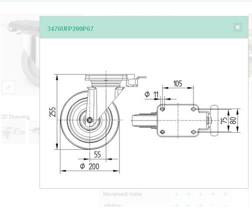

wheel drawing in A9Tech
I am trying to draw this image and this is neither belongs to me but i am just trying to get knowledge how to draw.please let me know where should i start
the image is
In this image their are more circles so i need to get the pointer for centre.
give me some hints to start this
I am unable to post the image so i am attaching the image and the image is from tent dot in website

I normally put a couple of XLINEs down to mark my starting point and use the Intersection OSNAP but you can just draw your first CIRCLE and use the Centre OSNAP. Draw your first circle declaring its diameter (or radius) and keep repeating at each successive diameter. Once you have all your circles you can draw the trunion and TRIM the bits away that you don't want.

you can draw the side view first and the use construction lines for guidance for your plan view :) shouldnt have much problems i guess..
In fact, not the best picture to start learning AutoCAD. Very little data is a task for the designer, given the basic parameters, and the rest approximately.

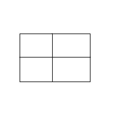

I have drawn this rectangle but i need to make this rectangle into 4 parts then draw circles etc
now where should i start for this things.the circles radius dont know
end: Are we talking about the top view of the wheel image you posted above? You realize you do not have any dimensions for the rectangle (as you call it) only for the diameter of the circles and centerline dimensions. How did you draw the rectangle then?
The circle's radius is not given but its diameter is. AutoCAD's circle command will accept either input. The default is radius. Type "D" to for diameter then input your value.

The hole diameters are called out in the upper left view.
Do you use 1st or 3rd angle projection where you are at? The drawing provided is 1st angle projection so if you draw 3rd angle you will need to move the views and adjust the views accordingly.

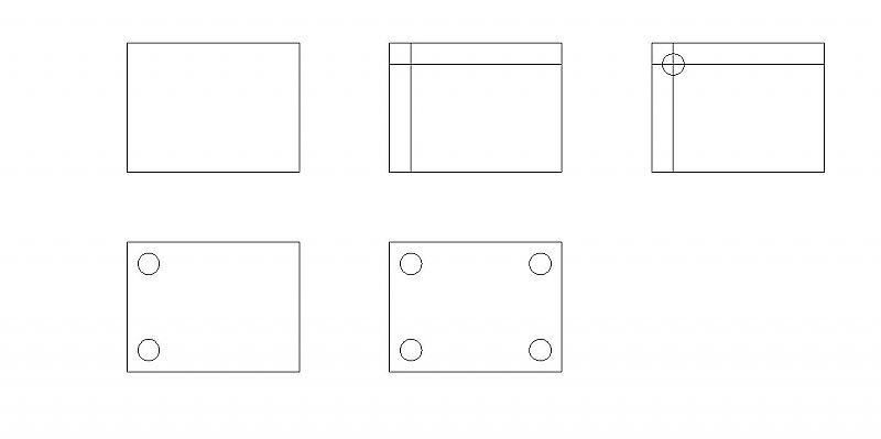

Very simply you could offset two adjacent lines (like at a corner) the required distances. Where they intersect is where the circle will be placed. Then use the mirror command to mirror the hole to the other side of the box. Use it again to mirror those two holes to the opposite side of the box. Got it?
By the way, draw everything FULL size in model space. Do not scale the drawing up or down for that matter. We'll worry about how to get the object printed on a sheet of paper "to scale" down the line.

To locate the center of the circle create an intersection by offsetting two lines. It might be the top line and the adjacent side line.
Please refer to the image below. It depicts the use of both the Offset command and Mirror command.
Two adjacent lines are offset to create an intersection point for our circle.
Once you have one circle it can be mirrored.
Once you have two circles they can be mirrored as well. You can also use the Array command for the circles but if you're having trouble understanding Offset and Mirror I don't think you'll immediately grasp the Array command.
You can use the Fillet command to radius the corners if they need to be rounded.
