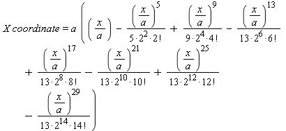

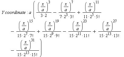

The only real problem I am having at the moment is converting the clothoid's formula to something usable in AutoLISP. At the moment I have the following formulae:
X coordinate: attachment 1
Y coordinate: attachment 2
Where 'a' is the 'steepness' of the curve which is defined by an earlier calculation and x the progression along the curve.
These formulae are entered into the mathematical software maple, which can convert them directly to string, C, Fortran, Java, MATLAB and Visual Basic format.
Is there any way I can use these formulae without having to spend hours converting them to the weird LISP format and probably still not having them work? I hardly have any knowledge about the VB language but would it be possible to use that format in LISP code somehow?

Hi Monkey,
How about something like this for the XCoord formula:
(defun fact (x)
 (if (< 0 x)
   (* x (fact (1- x))) 1))
(defun XCoord (x a / n i q)
 (setq n 0. i -1 q (/ x (float a)))
 (repeat 8
   (setq n
     (+ n
        (* (/ (expt q (1+ (* 4 (setq i (1+ i)))))
              (* (1+ (* 4 i)) (expt 2 (* 2 i)) (fact (* 2 i))))
           (expt -1 i)))))
 (* a n))
