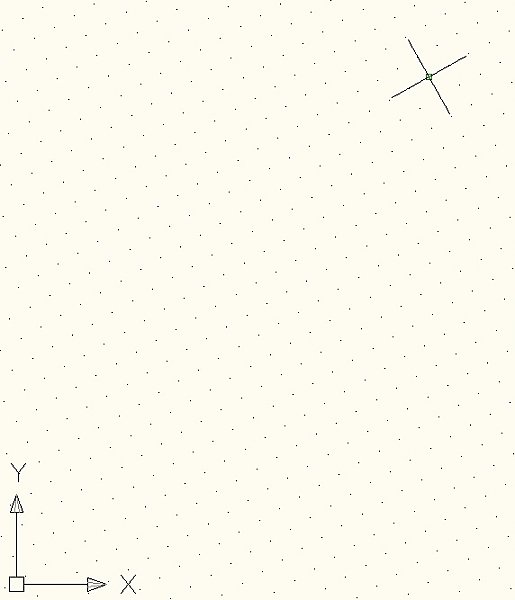

Hi all, sorry if this question has been posted before, but i adjusted my grid to a 30 degree angle so all of the dots are diagonal, i tried to revert by typing "grid" in the command prompt, but the aspect option is gone, this is what i get;
Command: grid
Specify grid spacing(X) or [ON/OFF/Snap/Major/aDaptive/Limits/Follow] :
aspect
Requires a distance, numberX, or option keyword.
while i kinda know that typing in aspect wouldn't be much help considering it isn't in the list of options, i didn't understand the response error it gave me, asking me for distance, numebrx, or option keyword, can anyone tell me how to revert or adjust that please? i'd greatly appreciate any help.
I wouldn't mind so much, except this is for a class, and i can't draw vertical lines anymore. thanks in advance! 8)

ok thanks, now how do i adjust the rotation/angle ordeal? ^^ it is still angled.
I am not sure what you mean by rotation angle.
Did you change the UCS?
i might have,
see how the grid is at an angle, and even the crosshair? i must have missed something, because i don't think it explains how to backtrack to + and not x
omg, i got it, i had to
Command: snapang
Enter new value for SNAPANG : 0
to re-align it, thank you for your help though, car, you did teach me that the icons at the bottom had a right click menu, which i never knew... i am just 1 day into the class, so i am still kinda durr.
