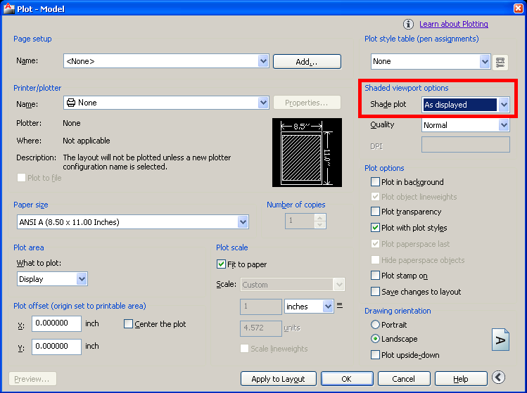

In your plot dialog box in your layout (or your page setup), there's a dropdown (not always visible, if it's not hit the little round arrow at the bottom of the dialog box) that allows you to change how plots are shaded. Make sure it says "as displayed" or whatever you prefer.
See pic for details:
Shaded viewport options is not highlighted, i do not have that little arrow at the bottom of my page setup window...
When you say it's not highlighted, does it not exist or is it greyed out? I probably won't be helpful for version reasons, but I'll keep checking.
Scratch that. When I open the plot dialog in the layout, it's greyed out for me too, forcing it "As displayed"
