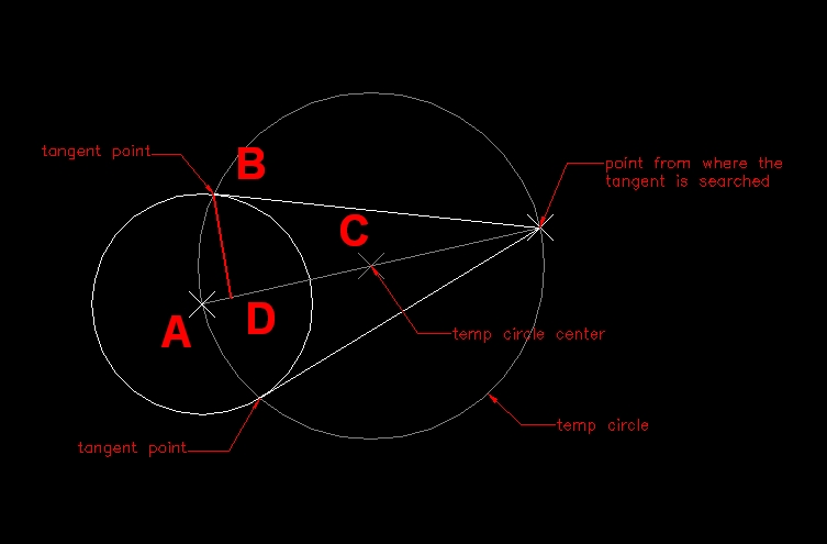

I have an application that creates a circle then a line based on inputs from a database. In real-time mode, I can easily create a tangent line from the endpoint of the line to the circle. How can I do this in VBA?
thanks
Hi,

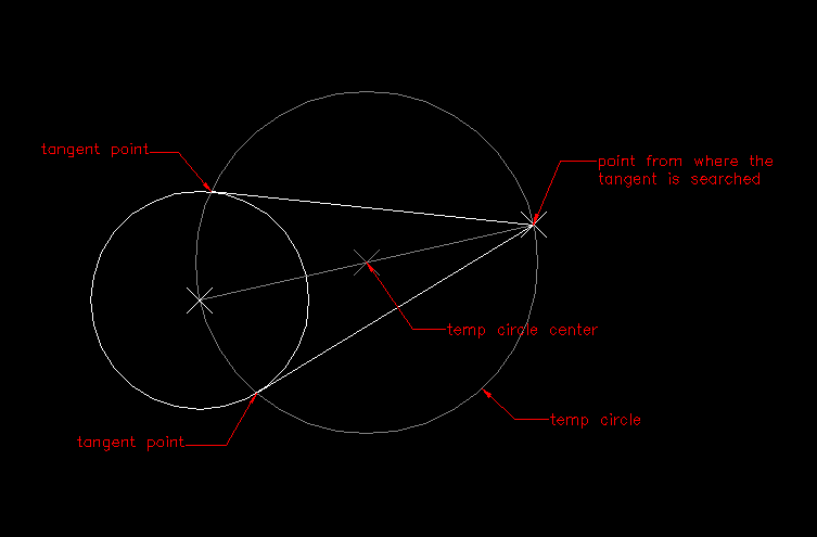

The easiest way should be invoking the LINE command with TAN osnap via SendCommand.
To avoid using SendCommand you can use a geometric method:
The tangent points from a point to a circle are the intersection points betwenn the circle and another one wich center is the middle of the line between the circle center and the point and which radius is the half of this line length (see picture).
Programatically, create a temporary circle as discribe, get the intersection points, delete the circle...

Gile,
Works Perfectly. Thanks

Very good Euclidean Geometry! This will help me a lot...
Taking the next step, you could determine the triangle A-B-C using the 3 known side values ( SideSideSide )
AB Radius Of The Circle
AC and BC The Half Distance
Known points A and C locate the triangle
Then find D as a perpendicular of B on AC. Now you have 2 right triangles to deal with.
Or there probably is some vlax call that finds the intersection points..... -David
But where's the fun in that :P
Hi,
No need to build the C point the triangle circle center, tangent point, external point is always rectangle at tangent point (a tangent to a circle is perpendicular to the radius at this point)
Hi,
I understand the perpendicular. I don't understand how you could reproduce the triangle. You really only know the length of the hypotenuse and the 90 degree angle. How could calculate either the length of either other side ( which are chords of an unknown arc ) or either other angle? -David
I agree. Also, where the knowledge? :) -David
Asumming you know the circle datas (center and radius) and the external point, you know the length of the hypotenuse and the length of the side from the circle center to the 90 degree angle (tangent point) which is equal to the circle radius...
I use this reasoning in this thread :)
