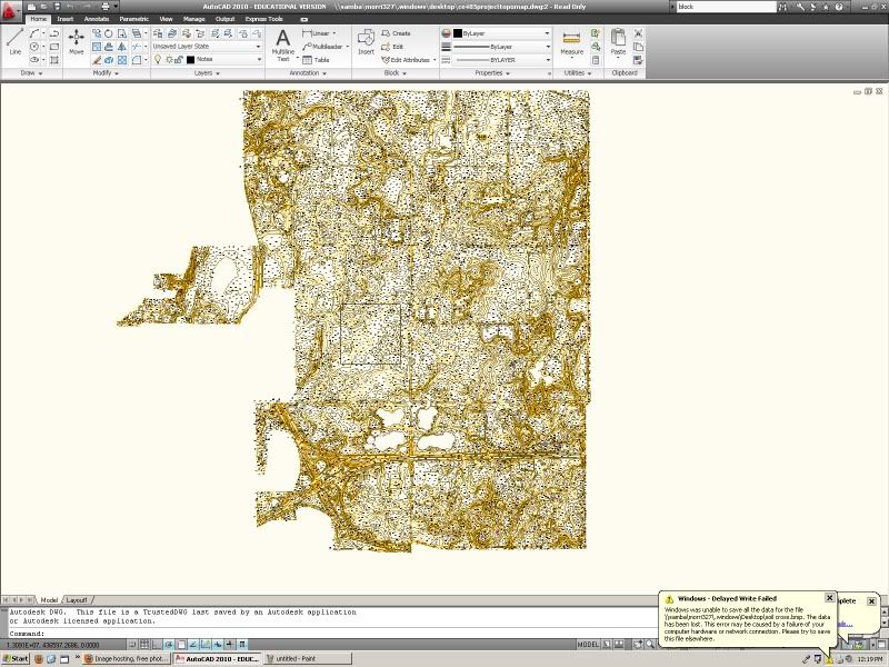

muchew Posted March 31, 2010 Posted March 31, 2010 Hello, I'm trying to make a cross section of a topographic map I was given in AutoCAD 2010. I have read up through the forums how to accomplish this, however I have been given about a 10 mile by 10 mile area. Where the area I need to create the cross section is about 2000ft by 2000ft. Does anyone know how to just cut this 2000ft by 2000ft section out of the map to create a smaller drawing file? Thanks, Matt Quote

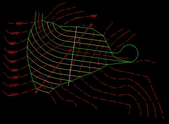

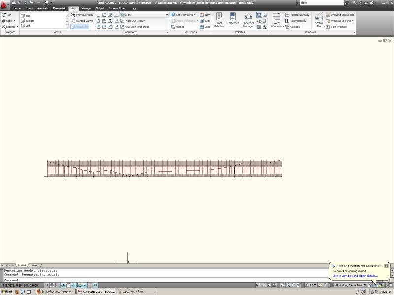

muchew Posted March 31, 2010 Author Posted March 31, 2010 Hello all, Ive been reading through the forums trying to get an idea of where to go. But i was hoping someone could give me a bit more clear picture of where I need to be going with what I need to do. For my Landfill Design class we have been given a topographic area on a drawing file. We are given a small area on this map to create a landfill. At this stage of the project I need to create a soil cross section (i have been attempting to do this with quickprofile.lsp.) I have been able to create a cross section, but having a hard time making it look nice enough to do any calculations out of. Anyways, eventually I need to create a final grade (of the landfill) compared to the base grade from the existing contours. I will also need to calculate the volume of the soil I cut out. Any pointers on how to get there? If this works, I have included some pictures of what I am dealing with. My only autoCAD experience is from a 3 month introductory course (that was focused on interior design, not civil engineering). Quote

muchew Posted March 31, 2010 Author Posted March 31, 2010 I have a guide to creating a 3D contour, but I do not want to make one of the entire map. Just the little square box that is my area. Quote
ReMark Posted March 31, 2010 Posted March 31, 2010 Then it sounds like you can just put a box around the site on the 2D map (drawing) and using the EXTRIM comand "trim away" the contour lines on the outside of the box (keeping the ones inside) and erase anything else you don't need. The result will be all the contour lines you'll need to work with. Quote
CarlB Posted March 31, 2010 Posted March 31, 2010 To get volumes you will need to cut (create) lots of sections, determine area of cut or fill at each section, then use the "average end area mthod" to calculate volumes. You can get an area at each section by drawing in the final surface, and use the "boundary" command to get an area between existing and final ground surface. Quote

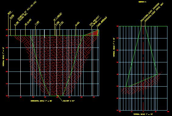

muchew Posted March 31, 2010 Author Posted March 31, 2010 That sounds pretty straight forward. How did you create your profile on the left picture? Did you use a lisp like quickprofile? Quote

Car5858 Posted March 31, 2010 Posted March 31, 2010 That sounds pretty straight forward. How did you create your profile on the left picture? Did you use a lisp like quickprofile? No lisp was used, just the survey data. On the top of the left photo are the stations. The left scale is elevation in feet. The left profile repsents the centerline of the driveway. Start with the survey data, add the contours at the survay data points. Add the length scale at the bottom. Then you have to do the cross section the same way. Then is is just doing the calulations for each box. Cut will be negative and fill will be positive. Quote
