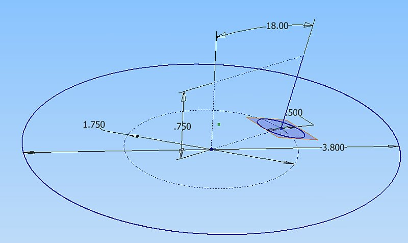

I created a circular plate, and extruded a hole through it at an 18° angle.
When I attempt to use the "Circular Pattern" command, I have a problem.
For "Pattern Individual Features", I can select the extruded hole. But, when I want to select the outer edge of the circular plate for my axis, the edge will not highlight.
How can I select the edge? What am I doing wrong?

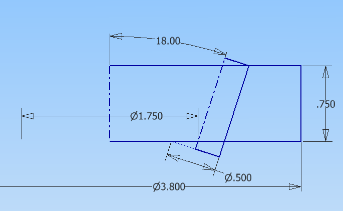

The part could be simplified even more with only one sketch.
A rectangle to revolve the disk and an angled rectangel to revolve cut the hole.
Here is the simplified method all dimensions in one sketch.
Revolve the disk.
Revolve - Cut the hole.
Circular Pattern the hole.
Done.
