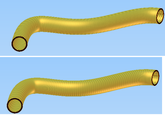

Here is a sample if I am following you correctly.
KC

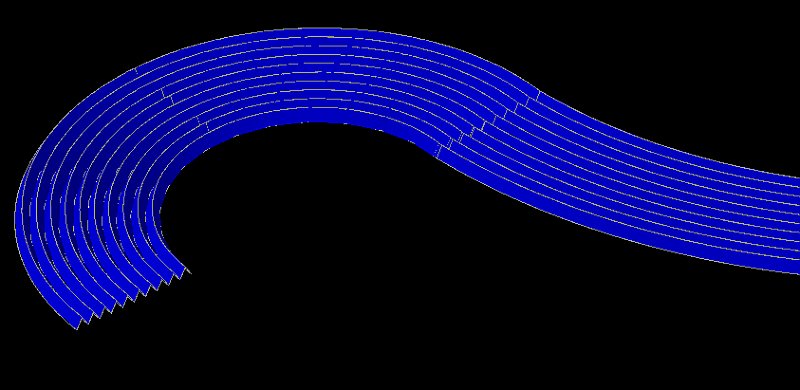

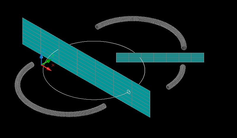

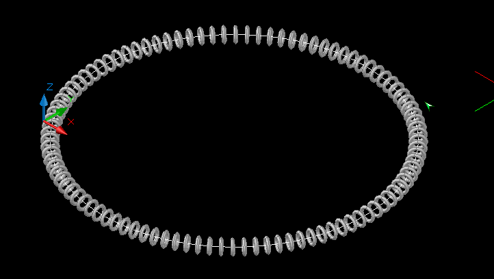

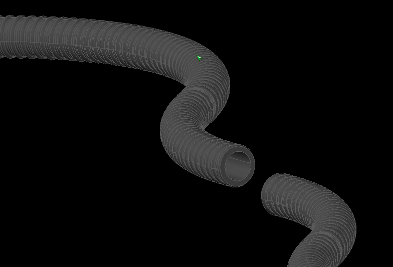

Well, It is possible but will take a little more than a few clicks.
You can use a combination of "Sweep" and "Polar Array" to get pretty much any angle you need.
Create your corrugated profile, sweep it around the smaller circle and use a polar array the new solid around a larger circle.
Then sweep 2 more circles for the outside and inside diameter of the pipe. Subtract the inside to make it hollow.
Now you can slice it into what ever angled sections you need. You'll have to repeat the process for larger radii.
Combine the solids so you can manipulate them easily.

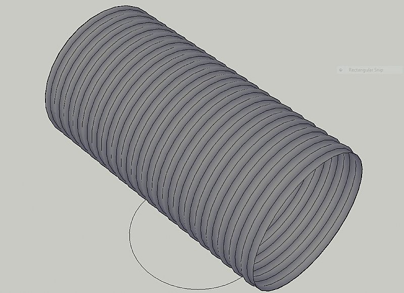

Here is a real quick Inventor example - one with cosmetic round texture and one with helix. Now imagine putting that in an assembly and backing out a bit on the view.
