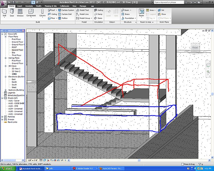

I would like the wall with the blue line around it to follow the red line around the stairs, is there a way for this to happen? I was thinking that i could do it the same way a railing can follow the stair but have been unable to find the embed to host command with the wall selected.

found a work around for this if anyone else ever encounters this problem.
i just edited the profile of the wall to follow the slope of the stairs. (something i didn't know how to do)

Thats one way to do it and it works fine.
You could also make a rail family that looks like a wall. This way you can host it to your stair.
