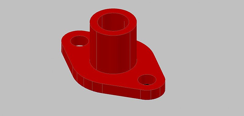

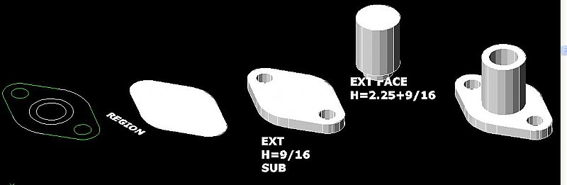

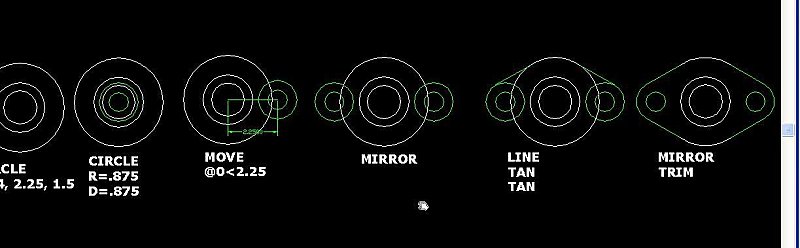

SFG13 Posted March 31, 2010 Author Posted March 31, 2010 Yeah you can see in the attachments what the drawing should look like: You can't see the first smaller middle circle but it's D=1, then 1.5, 2.25. I just canit figure out how to subtract the 3 circles. Quote

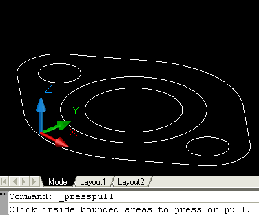

JD Mather Posted March 31, 2010 Posted March 31, 2010 Yeah you can see in the attachments what the drawing should look like: I'm not sure I understand - is the screen capture your work or someone else's work? Can't you simply attach your dwg file here? Looks like excellent use of presspull to me. Also - your dimensions don't look correct. If the large circle D=2.25 how are the small circles moved a R that looks to be about 2.25 and the R and D for mounting holes don't look proportional to the large circle? Quote
MikeScott Posted March 31, 2010 Posted March 31, 2010 JD's right of course (as per usual and I'm tempted to type that in my sig lol) However, since you wanted to know about subtraction, let's address that. You might want to change your SHADEMODE to 3d wireframe so you can see your shapes hidden within the main shape. They should have been regioned along with everything else, and extruded.. If not, that's your problem.. region it all together first.. Next, you can extrude it or don't.. it'll work either way, but it will give you an error message if you select a 2d object that has not be regioned first... This is because a region is the same thing as a 3d face. However, just to stay on the same page as your drawing instructions, go ahead and extrude it first. So, start the "SUBTRACT" command. First select the main shape, then hit enter Then select the two cylinders you want to subtract from the main shape, and the holes should appear immediately. Quote
ReMark Posted March 31, 2010 Posted March 31, 2010 The image you posted clearly outlines the steps, in order, to be taken. I'm having a difficult time understanding why you are unable to follow along. The two smaller holes you mentioned are the bolt holes for the flange right? And the two larger holes you mention must be the O.D. and I.D. of the center collar right? Look at JDM's excellent "demo" and keep in mind that before you use Extrude or Press/Pull that you can utilize Regions to accomplish part of the task. Note: We have talked in the past about the use of Regions. It seems you are still having a problem grasping the concept. I would consider asking your instructor for clarification on any concept you do not fully understand. Quote
