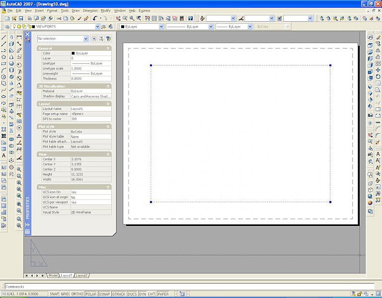

Tim1681 Posted March 30, 2010 Author Posted March 30, 2010 Screenshot attached. Viewport selected, PM shows "No selection." Quote

Tim1681 Posted March 30, 2010 Author Posted March 30, 2010 I just sent the same drawing to a colleague who is running the same version of AutoCAD and he was able to view the Viewport properties. I am currently going to do a computer restart. I will see if that fixes anything. If not I will do a fresh install. This is just looking more and more like a bug on my install. Here's why I think it may be a bug: When I don't have the PM open, and I select the viewport, and then Properties, when the PM opens, it stays blank. No content in it whatsoever. And then when I deselect the viewport, the PM loads all of the content and input boxes for whatever I deselected to. Quote

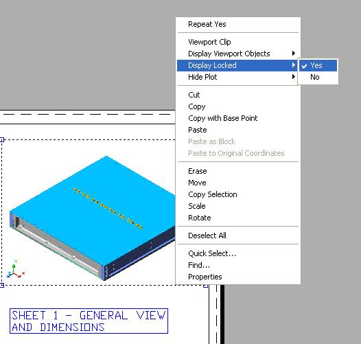

Crazy J Posted March 30, 2010 Posted March 30, 2010 Did you create this viewport or was it the standard viewport that you get when you start a new drawing (If so what happens when you create the viewport yourself? I'm right now dealing with this same kind of thing. It does seem to matter how you came about the viewport as to how you can get to the properties. Whether it was an ortho, a polygon, or clipped from another vp seems to matter. Unfortunately, I am not experienced enough to have figured it out exactly. But trying to create them from scratch is a good possibility. I am in 2002, so things may have changed also, but I have found out a few things the past couple days. Make sure you are in paper space and turn on the layer that has the actual box of your viewport. Select it like you would. Then try to right-click. See if you get this, and if so, then you need to unlock the viewport first before you can do anything else. You should also be able to choose properties from here. I typically don't keep PM open unless I am actively changing something. But then you might find it in the properties. Or up above on the viewports toolbar, you have some scale options. You can select your viewport, unlock it, and then enter/choose the scale there. Alternately, you might use the old command -vports to get at some of the features you need/want. Personally, I am finding the viewports to not be very intuitive, and the whole layer manager w/in each vp to be cumbersome. In theory, it's a nice idea to have this functionality, but in practice, it's very tedious... Good luck, hope these tips help you get where you need to go. Quote
