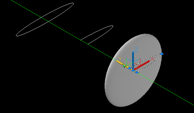

Hello!I am trying to make a convex len but I cannot...I made a concave one by intersecting two spheres but i can't imagine how to make the convex one...
Welcome in the forum!
Maybe you could try to SUBTRACT a sphere from a cylinder?
You could "revolve" a half elliptical profile or arcs depending on what shape your looking for.
Here I revolved half an ellipse around the "Y" axis.
KC
You are right, Kencaz. The method I suggested is for creating concave lenses
Thanks you!I made it by subtracting a sphere from a cylinder! :)
[ATTACH]18393[/ATTACH]
KC
Your method is very nice too...:wink:
How about if you Interfere a sphere and cylinder, instead of subtracting?
Try revolve command
Draw the upper half of the convex lense and revolve it over the base axis
I tried it!To my opinion is very useful as in subtracting you lose the solid you subtract while here you can use it...It works like the slice command!
