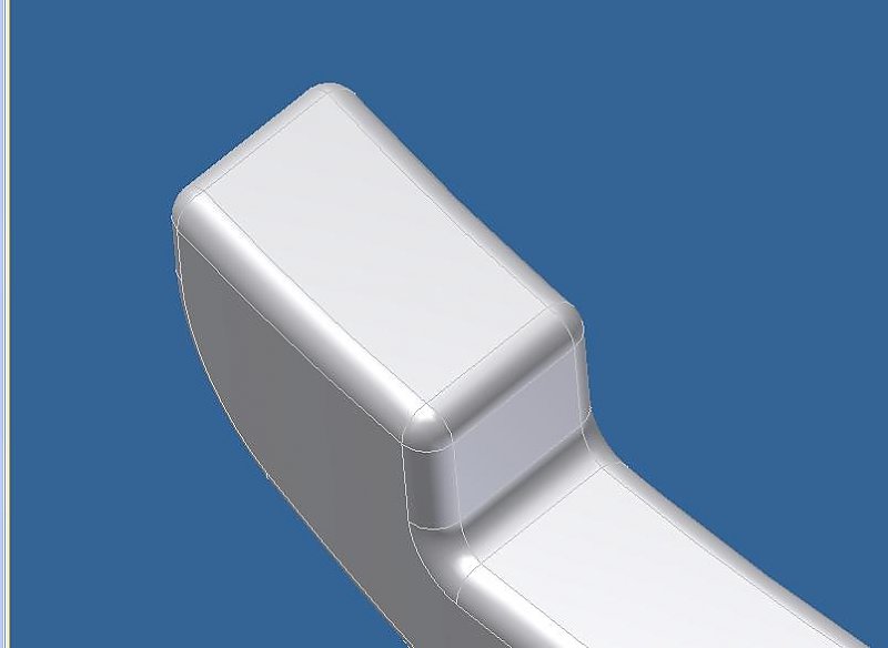

well part of the trouble the fact that you added fillets to the first sketch. I would advise that you dont add fillets in the sketch. This will give you greater control over them in the modeling environment as well as make updates/changes easier.
When you try to fillet an Edge it is going to select the edge and all tangent section of that line. So you are going to get a fillet all the way around the body until that sharp transition where the 15degree angle starts in your top view.
About your only option as it stands is the FaceFillet but the results will not match your acad file.
I would go back to your original sketch and remove your sketch fillets.

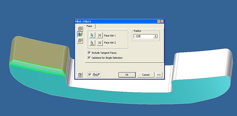

Here are some screen shots showing you face fillet. The last image was after removing the sketch fillets and doing the fillet operations on the solid model.
FaceFillet did not exist in Inventor 8.
DOH. well i guess i stand by the remvoing sketch fillets option completely then. :)
