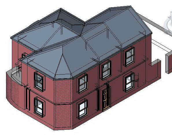

I'm in the process of trying Revit for the first time. Attached is a view of a project I doing at the moment.
As you can see, some lines are shown that should have remained hidden, and I don't know how to remove them. All I want to see are the external walls. If anyone could help, I'd be very grateful.
-pick the objects you don't want to see
-right click
-hide in view
-elements
This happened quite often when I was using Revit 2009. I had to delete the 3D view and create a new one. I don't know if it was a bug or a hardware issue on my end.
Thanks for both your suggestions.
Moe - I'm trying to remove the hidden lines, not elements. Thanks tho.
Prof - Thanks, just what I am looking for.
