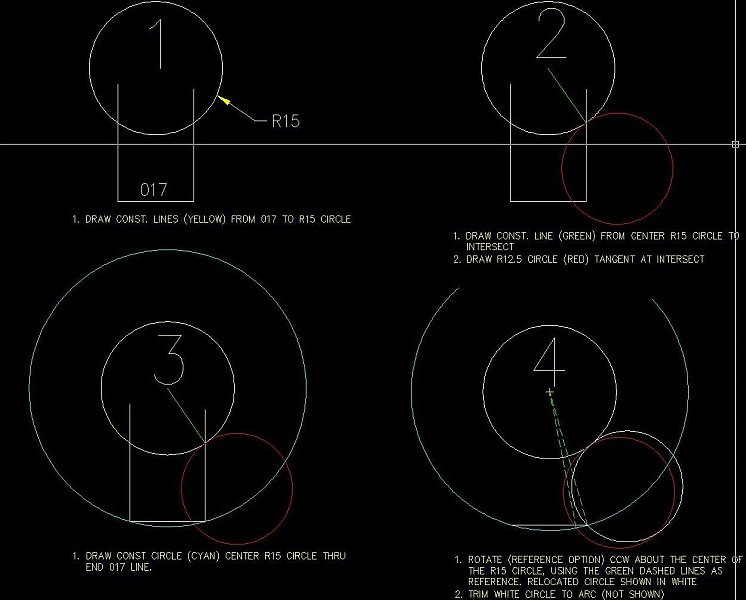

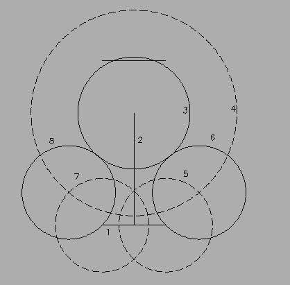

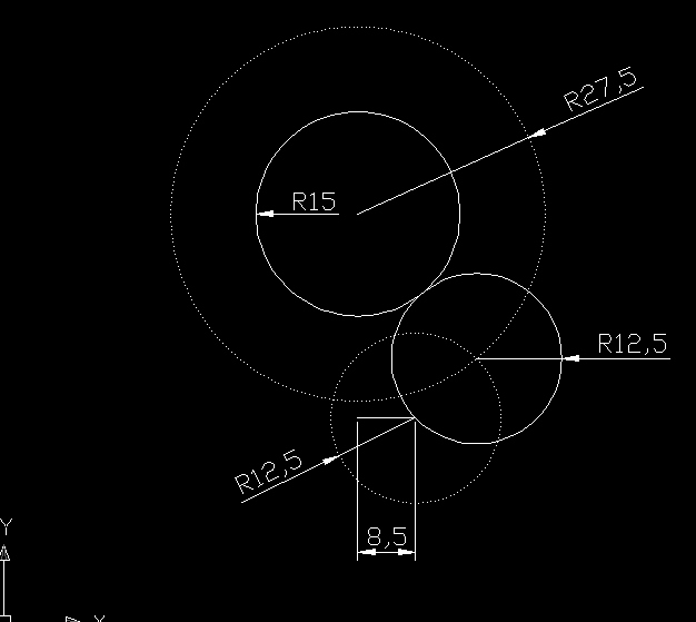

CAD_Spider Posted August 21, 2008 Posted August 21, 2008 Hello I started using AutoCAD a few months ago, and I completed a college assessment. During the learning process, I developed some bad habits with regards to geometrical problem solving. The college taught me absolutely nothing on the subject, and I don't want to start an advanced course until I'm proficient with geometry. Can anyone recommend a book or online tutorial, that would enhance my skills in this area? I have attached an image to help you understand my point of view. One task on my course involved drawing a screwdriver. The attached image shows the construction of the screwdriver handle. The solid lines are part of the screwdriver's shape, whilst the dashed lines are construction lines. What tells a draughtsperson to draw a "construction circle" with r27.5, and another construction circle with r12.5, on the far RHS of the horizontal line? Am I overlooking the bleedin' obvious? Thank you! Quote

CAD_Spider Posted August 21, 2008 Author Posted August 21, 2008 you've got me stumped! what was the wording on the assignment? still can't figure out what we're supposed to be looking at in that drawing Sorry .... I've attached a picture of the screwdriver handle. The wording is, "Using relevant commands draw the screwdriver as shown in the diagram". Does that clear things up? Thank you for trying! Quote

CAD_Spider Posted August 21, 2008 Author Posted August 21, 2008 ah, that makes a bit more sense what's your arithmetic like? - you're going to need it :wink: which point did you start your drawing from? My Rithmatic is fairly good I started by drawing the circle with a radius of 15. Then, 30 units below the centre of that circle, I drew the horizontal line (17mm in length). Could you give me guidance about the next stages? I can do this particular task, but only after minimal guidance from a college tutor . I don't understand the logic that led to the construction circles (see the diagram at the top of the thread) Thanks! Quote
Strix Posted August 21, 2008 Posted August 21, 2008 look at the smaller circle.... of radius ?..... now what do you get if you subtract the biggest circle from it's inner circle? Quote

CAD_Spider Posted August 21, 2008 Author Posted August 21, 2008 look at the smaller circle.... of radius ?..... now what do you get if you subtract the biggest circle from it's inner circle? 12.5 ... but ... Imagine those construction circles weren't there! ..... what tells you to create a construction circle of 27.5? Also, what tells you to put the other construction circle on the RHS tip of the horizontal line? Quote

Strix Posted August 21, 2008 Posted August 21, 2008 12.5 ... but ... Imagine those construction circles weren't there! ..... what tells you to create a construction circle of 27.5? Also, what tells you to put the other construction circle on the RHS tip of the horizontal line? it's the smaller circle you're drawing that's dictating those figures Spider :wink: what are the construction lines doing for you? DB - I was thinking ARC may be easier to place than a CIRCLE - Start:tangent, endpoint:endpoint, radius ? no? (with no messy construction lines at all) Quote
dbroada Posted August 21, 2008 Posted August 21, 2008 remember I'm an old fasioned draughtsman so don't do everything "the modern way". I would... draw my large circle. put a horizontal XLINE through its centre. move the xline 30 down. put a vertical xline through the centre move the xline 8,5 right draw the 2 circles you have got. copy my horizontal xline 44 up. trim away excess mirror in other words, much as you have done. It may be possible to using tracking (or SNAP ) to skip certain steps. Quote

lpseifert Posted August 21, 2008 Posted August 21, 2008 Try this Project const lines up from the end of the 017 dimension to the 15R circle; draw an arc Start, End, Radius from the intersection of the circle and the const line to the 017 line with a radius of 12.5 Quote

CAD_Spider Posted August 21, 2008 Author Posted August 21, 2008 Try thisProject const lines up from the end of the 017 dimension to the 15R circle; draw an arc Start, End, Radius from the intersection of the circle and the const line to the 017 line with a radius of 12.5 Ok, I'll give that a go later! Thanks Quote
