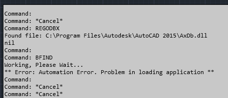

rustym Posted May 19, 2015 Posted May 19, 2015 Hi Lee Can't get it to load in 2015? See image for error. I've tried the RegisterObjectDBX.lsp but seems like not working in my case. Thanx Quote
Lee Mac Posted May 19, 2015 Author Posted May 19, 2015 Do you get the same result after restarting AutoCAD? Quote
rustym Posted May 19, 2015 Posted May 19, 2015 Yes same error. Tried it a view times after restarting. Edit: (Sorry let me re-phrase, the application open, but as soon as I try to find the error show's) Quote
Lee Mac Posted May 19, 2015 Author Posted May 19, 2015 I'm not entirely sure what to suggest, other than perhaps a reinstallation of AutoCAD Quote
