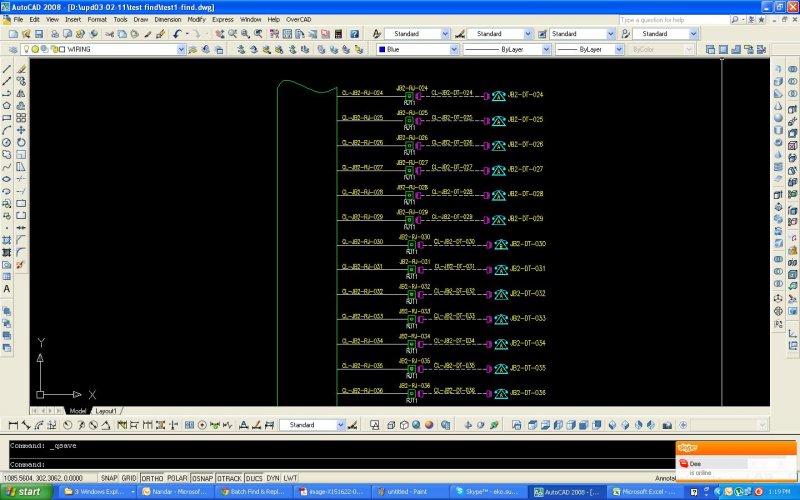

esputro Posted October 16, 2012 Posted October 16, 2012 Dear Lee, Great lisp and thanks for your kind, first time i tried this lisp was great and yesterday i had problems with my drawing after i find and replace with V2.0 Version. The last sequences that i replace was repeated againt (please see attahment drawing), i dont understand wky this happen, please advice. for information i used autocad 2008. Thanks you, Regards, esputro test1-find.dwgFetching info... Quote
Lee Mac Posted October 16, 2012 Author Posted October 16, 2012 Hi esputro, What find pattern did you search for, and what did you use as the replacement string? What result were you looking to obtain? Quote
esputro Posted October 17, 2012 Posted October 17, 2012 Hi lee, thanks for prompt reply, sorry i had mistakes with my sequences number, it solved with your great lisp. Thanks again for your lisp. rgds, Quote
