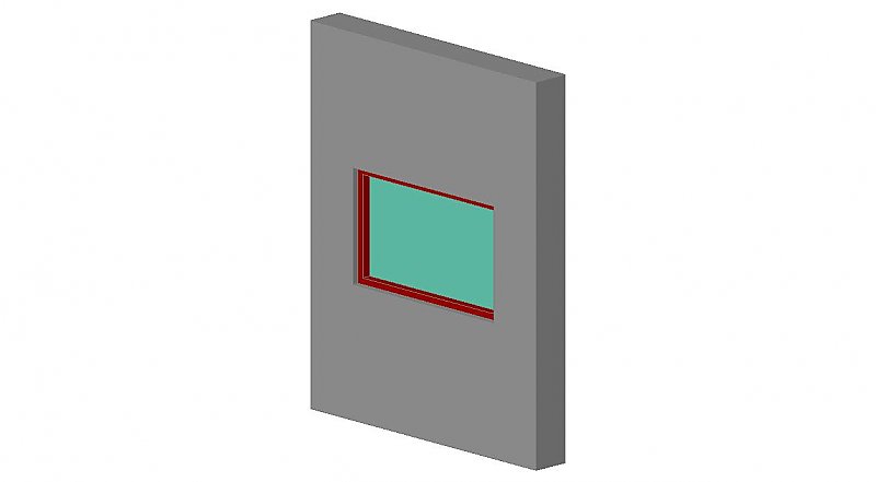

ReMark Posted March 22, 2010 Posted March 22, 2010 I'm sure you are smart enough to realize that a wall, a window frame and a sheet of glass are separate objects. All you did for your "window" is remove some part of the solid wall but you put nothing there for the window itself. Look at the example below. There is a wall, a window frame recessed into the wall and a piece of glass in the frame. They are three distinctly separate objects each on its own layer (Wall, Window Frame and Glass). I can now asign materials to each of those layers rather than the objects themselves if I want to. The image below makes use of the Realistic Visual Style. No materials have been applied yet. The angle of view is slightly askew to show that the frame and the window glass are both recessed. By the way...the window sits in a void I created in the wall. The opening for the window does not pass entirely through the wall. You could do the same thing with your building. Quote

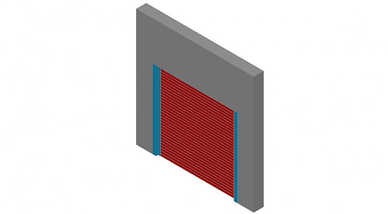

ReMark Posted March 22, 2010 Posted March 22, 2010 The image below depicts a wall with an overhead door inset into a void created in the wall itself. Layers for the steel framing members (channel and angle) and for the door itself (OHD) were created. The Wall layer is the same as previously constructed. Again, the image is shown in Realistic Visual Style (no materials assigned yet). You could do this as well in your drawing. If the windows and the overhead doors you have in your building are the same size then you only have to make each one once and copy them where needed. Quote
