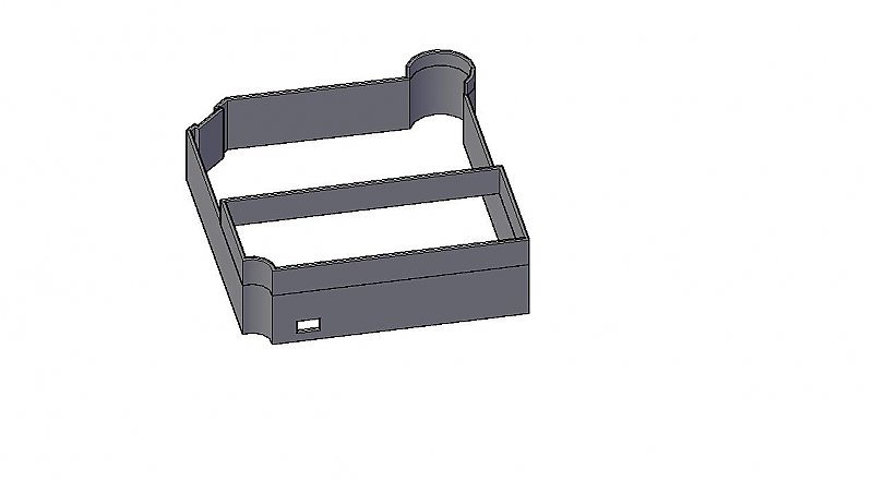

ReMark Posted March 22, 2010 Posted March 22, 2010 Here is your building with 1) walls and 2) a "window" punched through the wall. I left off the roof so you could see that it is hollow inside just like a real building would be. Quote
pbooth11 Posted March 22, 2010 Author Posted March 22, 2010 ReMark said: Here is your building with 1) walls and 2) a "window" punched through the wall. I left off the roof so you could see that it is hollow inside just like a real building would be. [ATTACH]18268[/ATTACH] when i SU the inner from outer wall i got a response of 'null region created - deleted' ?? i understand how it should look but i dont seem to be able to correct the process u indicated...........how did u create this from my drawing ^^^ ?? Quote
