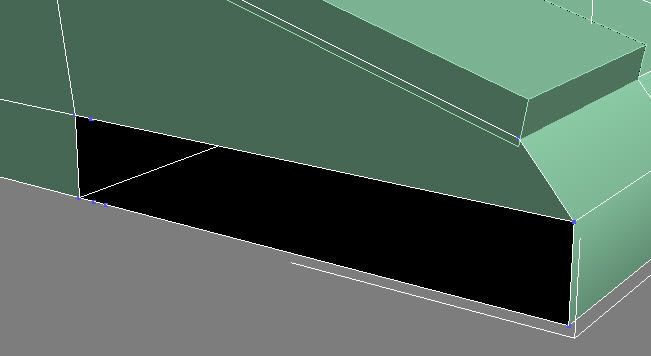

Is it possible to create a face?
I was trying to create a hole for the phone line jack.
It screw up and I deleted the polygon...
Theres a hollow now...
Is it possible to cover it up? I think its called a face?
THanks

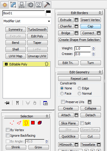

First you need to delete those extra vertices. Once you've done that, switch to "Border" sub-object selection mode, click on one of the open edges and then hit the "Cap" button.

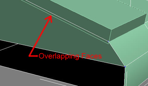

It looks like you have some overlapping faces also?
You might want to fix that, otherwise it will cause problems when you render.

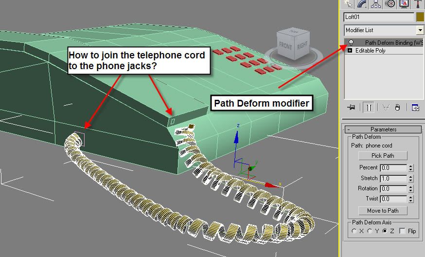

So I went ahead and drew a small rectangle instead of messy with the polygons and positioned against the body of the phone.
Then I followed this tutorial and got the telephone cord.
Problem now is, how do I join the telephone cord to the phone?
I can't seem to make modifications to the modifier through editing the polygons.
Take a look at this video tutorial. There's no sound, but it goes slow and it's easy to follow.
