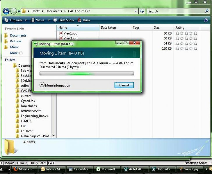

I am pretty sure a drawing file is not in use or opened (but I am not sure if something is accessing, e.g. system files but surely not a virus) when I am trying to manipulate. An example is when I try to move a .dwg file to another directory, the move/copy dialog will keep on discovering the item almost forever, lol, I tried it to wait for 30minutes but nothing happen, please see screen shot below. Another example is when I try to access its properties by right click on the drawing file then properties, the dialog window doesn't appear. Also when I try to reopen in Autocad, the program freezes or is not responding anymore and cause it to crash.
