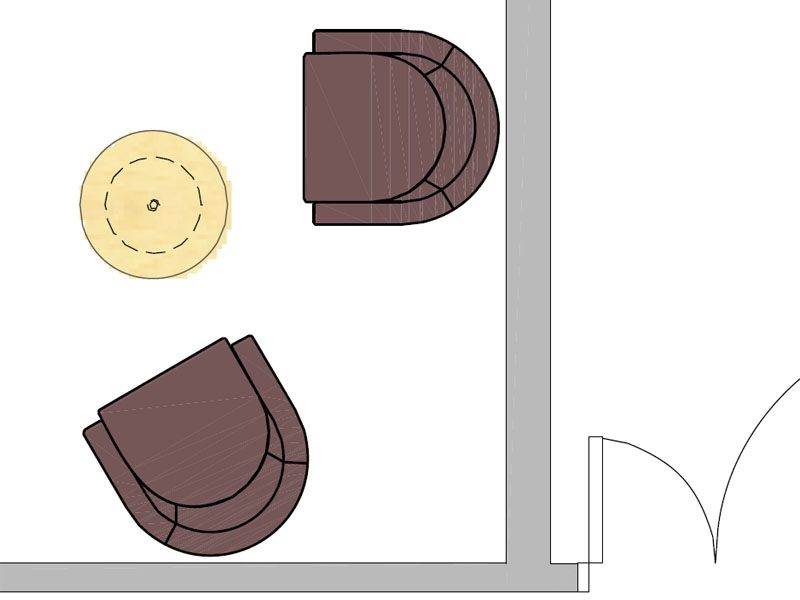

busseynova Posted March 17, 2010 Share Posted March 17, 2010 Hi. Me again:roll: How do you print PDFs - that is not that I don't know how to do it at all, but I wonder if there's a better way than I'm currently using. Using the Adobe PDF printer, or the ACAD 'DWG to PDF' printer to print from a scaled viewport within a layout, I tend to get all kinds of errors all over my hatch and image hatch areas, like in the picture below. Increasing the resolution loads - to 1200dpi, doesn't seem to do anything. Ultimately I also export the PDF to a flat JPG as the layered nature of the PDF usually makes it painfully slow to load and would crash most of my clients computers. So what I am saying is if there's a way to bypass the PDF printers and print straight to high res JPG that might be good. I realise there's the JPGOUT command, but this just exports a 72dpi image as far as I remember. Quote Link to comment Share on other sites More sharing options...
