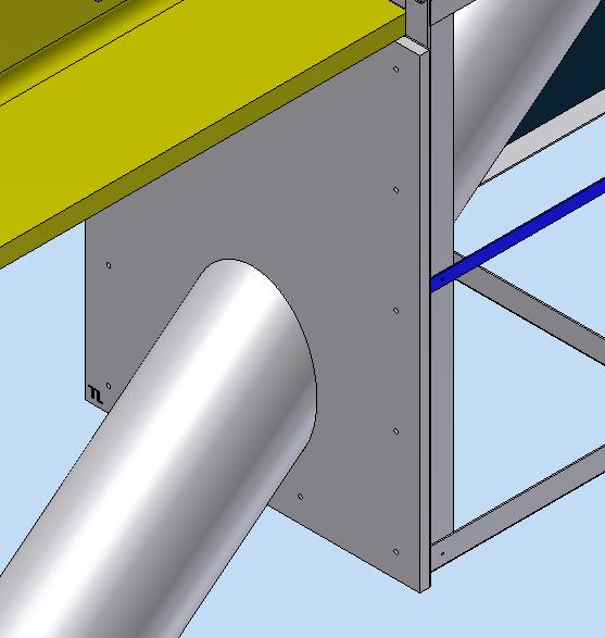

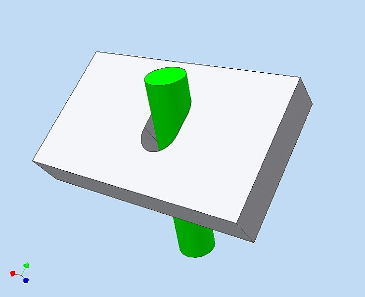

I have a query again. Hope that you can help me again. I do have an assembly consist of a plate 20mm THK. and a Pipe Ø273mm. The Pipe penetrate through the plate in a certain angle "let say 45°". How do I cut the plate following the angle of the pipe.
I have tried the Project Cut edges and the Project Geometry but that does'nt help. I have attached a jpg of the scenario.
In the .iam, right click into the plate part, edit, and a work axis by selecting the angled pipe. Open the plate part up (you should have the axis in there, which is refrenced to the angled pipe), and create a work plane perpendicular to the axis ... draw your circle, and create a projection (remove material, through all), and you should get the ellipse cutout you require.
Are you wanting the cutout to be non-angled? If you require the flat profile geometry to export for NC processing, the above method will produce double profiles where the cutout is due to the angled edge of the plate. To produce a clean profile, it's a bit more involved ...
I'm still working on a cleaner solution to do that ...
Hope the above helps.
Thanks linnmaster,
The first step did the work, it creates a hole following the contour of the pipe and the angle as well. :thumbsup:

I projected the cut edges in both sides of the plate and joined them with straight lines to obtain an elongate hole

here is a possibility to solve the problem. This is a slot cut perpendicular to the plate which is more likely the way it is cut in real life ether with oxy or laser
it needs some clearance of course
