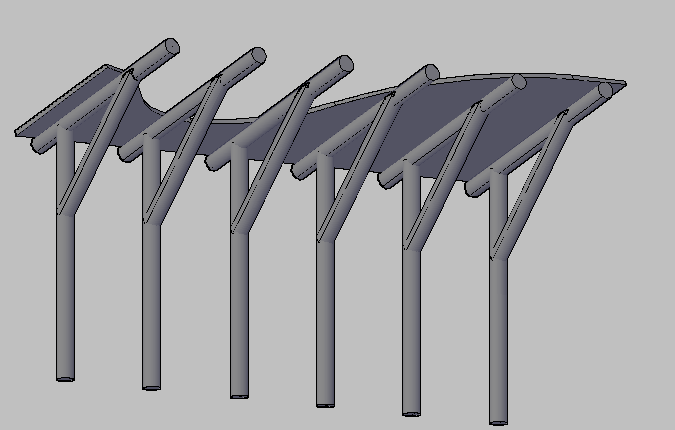

Okay, so im pretty new to autoCAD. I'm using Architecture 2010.
I basically started drawing and by means of extruding, rotating and slicing, came up with this drawing (see image). Now, i basically want to create an exploded view of it. I want the exploded view to show the whole roof part like lifted a few feet above, the round beams to be separated, you get the idea.
I first just tried using the explode command, but when i do that parts of my drawing just disappear completely, and the rest doesn't explode. I did some reading and i'm thinking that i need to create blocks, and then the blocks will be what explode?
So my question is do i need to create blocks to do what i want to do?
And How do i create blocks from my drawing?
(Basically I want each beam to be able to separate and the roof to lift off in the exploded view)
Explode is used for a different purpose then creating exploded views.
You will have to create the views by moving your items apart one at a time.
If they are 3d solids they need to separated in order to move them apart from one another.
Use "SOLIDEDIT" command to separate them.

I'm assuming the roof was not "unioned" to the beams and remains a separate entity, correct?
I'm also assuming that each column/beam/kneebrace has been unioned, correct? If so, the Separate command will not work on them. You would either have to Slice them, which would take some doing, or recreate them as individual entities.

I would redraw them.. It's better to plan for an exploded view, than try and slice all that up, especially since you're dealling with curved surfaces that would require some tricky slicing.
You could easily slice the roof off the supports, but the rest might be a challenge, unless release 2010 allows you to slice with objects, rather than planes?
When you redraw the cylinders though, you'll need to use the subtract command to get that curve in the tops of them where they interconnect with each other.. or they'll just look like uncut tubes... same with the rectangular pieces

BLOCKS don't do what you think they do. Blocks are groupings of entities that can be moved as a single unit, and can be re-used all over the place (including other drawings if you put them on the tool pallette.
EXPLODE also doesn't do what you think.. that'd used on blocks (and some other items, like plines) to break them into the separate part's they're made of. If you've "unioned" something (3d items).. they are not separate parts anymore, they are essentially one big piece.. cast together as it were. So when you explode that.. it sometimes breaks into faces, sometimes other stuff.. depending upon how they were created.

You'll be able to show them assembled or separated, or copy the whole thing into multiple locations and show both at once.. you'll just have to move the parts around manually to get them to do that.
You COULD make a block of a single stand, if you thought you might need to use it in several locations elsewhere. Like if this was part of a promenade deck or something. OR, you could attach all the items of the entire assembly, if you thought you might use it like that instead (or as well).
You said "joined" .. if you blocked the parts of a stand.. they'd be "joined". If you exploded it, it would revert back to being separate entities, rather than a group.. it wouldn't move them away from each other, they just wouldn't all respond as a group anymore.
