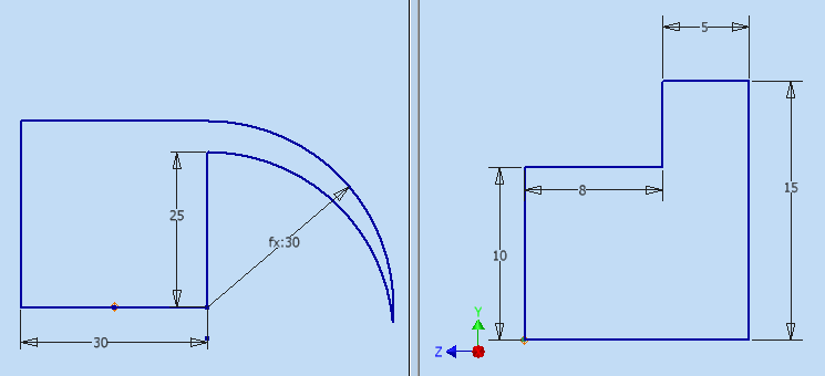

Well I see you are using an earlier version of Inventor so you would not be able to open my files - but attached is a screen capture of what your sketches should look like fully constrained with geometric constraints and dimensions.
Using equal = constraints reduces the number of dimensions needed to control a sketch.
Notice that the sketch should change color indicating fully constrained. If you use the origin in a logical location the assembly constraints will be much more logical as well.

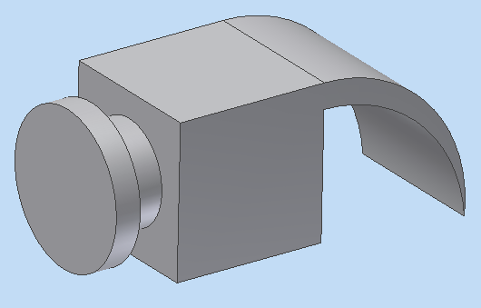

I'm a bit confuse on your design intent. Is something like attached image what you are after?
