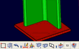

kencaz Posted March 14, 2010 Posted March 14, 2010 Thanks KC I think Inventor is not that much user friendly like AutoCAD and I don't know why they didn't use those very handy features of AutoCAD like object snap here! Anyway I carry on and ask you guys more question and thanks in advance for helping me as always. AJ Well, transitioning to Inventor, (a parametric modeler), from AutoCAD, (a free-form modeler), takes some getting used to. I would not say one is better then the other since they are entirely diff types of applications. I also wish Inventor had some AutoCAD commands and vice-versa but I would not want to have to choose between the two. If I did I would have to go with, (I'll get a lot of flack for this), AutoCAD, since it is more versatile and I can do 3D in AutoCAD fairly well, but Inventor is really superior for mechanical design which is what I do mostly. This is one command I would love Autodesk to implement into Inventor. Taken from KeyCreator: KC Quote

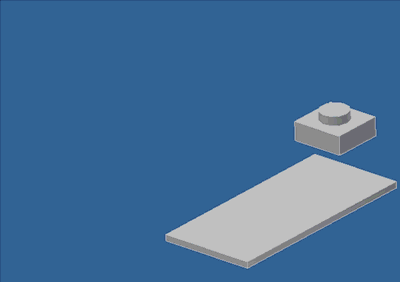

kencaz Posted March 19, 2010 Posted March 19, 2010 Hi All, I'm new to Inventor and coming from AutoCAD. So far so good but the logic is completely different. I have 2 parts a Box and a Cylinder. I want to put the center of the Cylinder on the midpoint of one of the faces on the Box. When I use mate constraints I can pick the center grip of the Cylinder but unlike AutoCAD I can't find the midpoint of the Face to drop it there. How can I do that? Cheers Ali To get back to your original question... I did find kind of a work around to get the center of your rectangle. It's not as simple as M2P in AutoCAD but you don't have to measure anything or create a new sketch. First edit your part in the Assembly with a right click. Then choose "Work Point", select the face, right click and choose loop. Choose the top edge of the rectangle and you have your point. Save you edit then insert your cylinder on that point. Hope it helps. KC Quote
alijahed Posted March 19, 2010 Author Posted March 19, 2010 To get back to your original question... I did find kind of a work around to get the center of your rectangle. It's not as simple as M2P in AutoCAD but you don't have to measure anything or create a new sketch. [ATTACH]18185[/ATTACH] First edit your part in the Assembly with a right click. Then choose "Work Point", select the face, right click and choose loop. Choose the top edge of the rectangle and you have your point. Save you edit then insert your cylinder on that point. Hope it helps. KC Thank you very much I'm going to check this out tonight. I am still thinking why they haven't put those useful AutoCAD features in the Inventor!!!!!!! Cheers Quote
