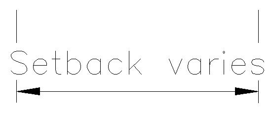

I am looking to modify my dim style so that I may get something that looks like the attached picture.
Is it possible to do this? So that there is a gap between the dim lines.

Yeah set the fill colour to background onthe text tab in dimstyles
