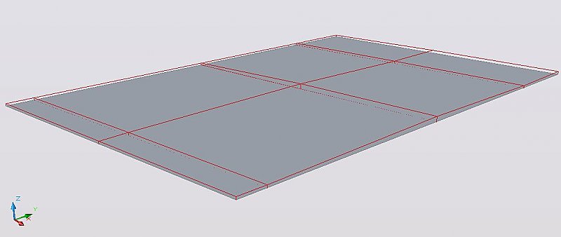

neo_clear Posted March 11, 2010 Posted March 11, 2010 After any assistance on this one please. I have drawn a simple (enough) wire frame of a slab area, the slab has multiple falls in different directions and various high points that have been drawn up in 3d modelling space on AutoCAD 2007. My goal is to make the wire frame a solid to determine overall volume - this would be really useful for a variety of things I do at my work. I have created a region for the base of the frame via a poly line but am struggling on linking the top of the frame to this and generally creating the solid. Tried extruding however it only creates flat surfaces (to my knowledge) and as mentioned about the top of the area has 3-4 different z values. Any assistance would be a big big help. Quote

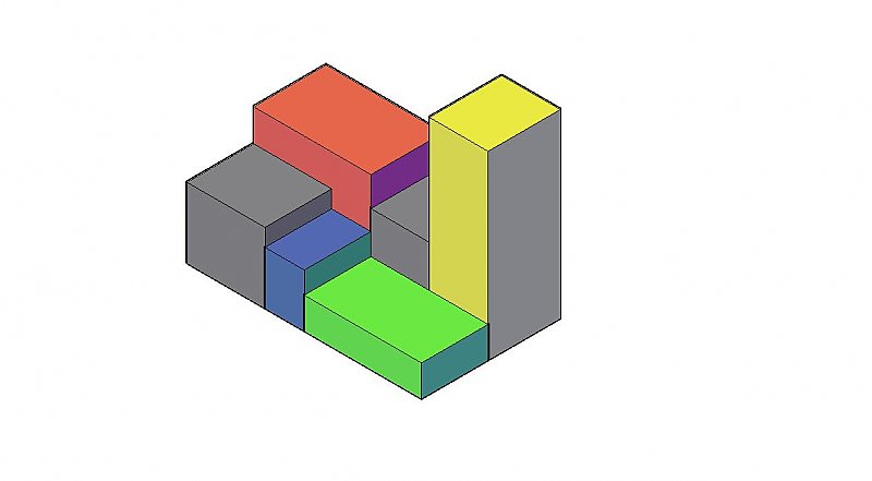

ReMark Posted March 11, 2010 Posted March 11, 2010 Are the areas with the different Z-values flat? Quote
ReMark Posted March 11, 2010 Posted March 11, 2010 Does your slab look like the image below or more like a mountain range with peaks and valleys? Quote
neo_clear Posted March 12, 2010 Author Posted March 12, 2010 Looks like a mountain range rather than flats on different levels, please see attached pic which is exactly what ive done. Its hard to see due to the size of the slab but there are small falls from the stop surface lines, while the base is level (0) Quote

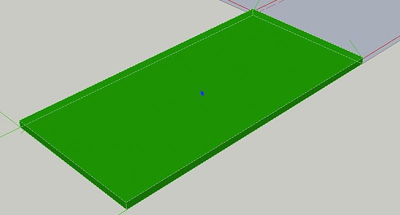

neo_clear Posted March 12, 2010 Author Posted March 12, 2010 Yes thats basically what I am attempting to do. Have managed to extrude the slabs areas, taking the highest point in the area. I understand the concept of the slicing however it is proving a bit tricky for someone at my level as basically i want to select 4 points, the start high point and the 3 lower levels I wish to slice to. The picture below should explain what i am doing. The base is effectively 0.000m and the whole area has been extruded to the highest point 0.232m The desired levels for the corners are as follows North corner - 0.135m East corner - 0.192m South corner - 0.232m (high level overall extruded hieght currently) West corner - 0.177m Again comments are really appreciated and thanks again Quote
MikeScott Posted March 12, 2010 Posted March 12, 2010 In geometry, a plane is a surface that travels to infinity. When you slice, you are selecting three points that occur on that cutting plane you want to use. To define that plane using that square, pick two points along one face edge, and one point along another edge of that same face. The points can come from anywhere along those two lines, and they will tell AutoCAD where that cutting plane needs to be. The cutting plane is illustrated in this image as a red line.. so in this case, I'd run the Slice command, then select the slab, and then pick three points from anywhere along those 4 red lines. (no more than 2 points per line though). Then select "B" to keep both sides, and then erase the side you don't want. This works through overlapping the slab with the cutlines you have shown in your original image. Switch to 3d wireframe view so you can see the cutting plane inside the slab. Perform this on each square of your slab, and then use the Union command to rejoin them as a single slab. Quote
