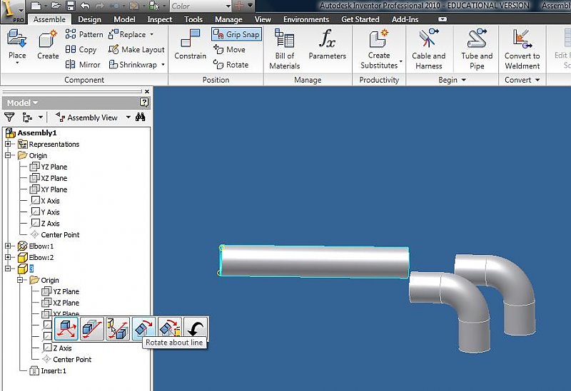

jimmetry, the method i was speaking of is available for multibody parts in 2010 as i was just trying to give another option for the users because features change from year to year. In 2010 you could draw all your parts in an ipt file, use move body and so on then create an assembly(if you want) from this part file. When i started to explain this i forgot he was using 2009. Once you move up in software its easy to forget the things that were left out of the last version.
The method kenkaz was speaking of should be available in 2009 but i dont recall the exact nomenclature as I do not have 2009 anymore. If there is a GripSnap button on the ribbon then you can use that to achieve this. This will let you select an axis that is located in your part(parts origin folder specific to this part and not an origin of another part) and enter an angle.

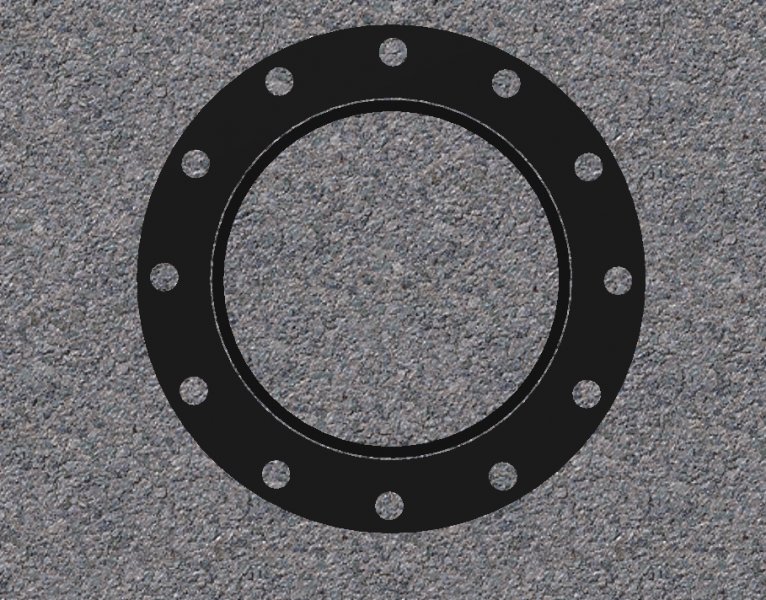

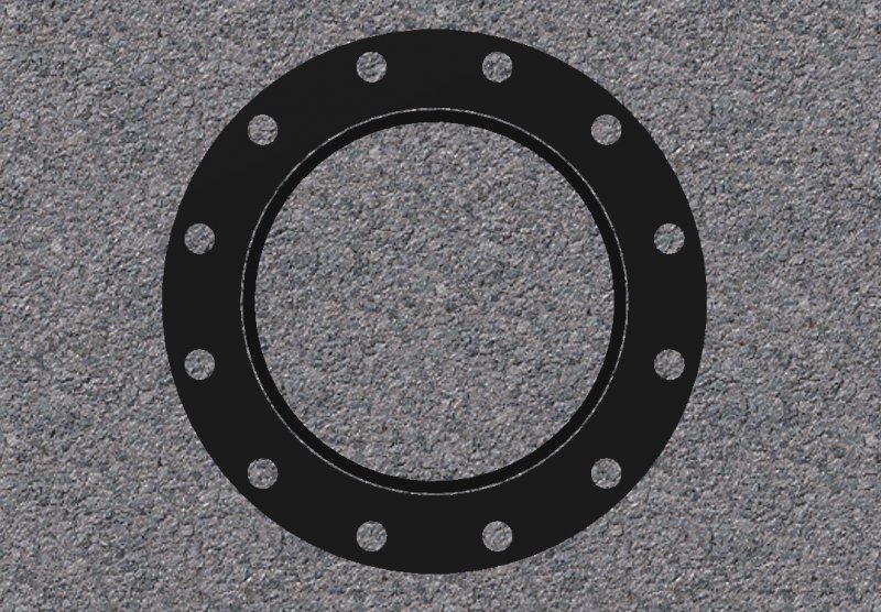

How would you guys do this: Ihave a flanged pipe spool assembly that is flush with a wall, I want to constrain the spool so that the flange bolt holes are off-centre, at the moment I am calculating the rotation degree needed manually then rotating the part by that value, then adding a motion constraint between the spool and the wall (which is grounded).
On left is what I start with (bolts holes in line with centreline) on the right is what I want (bolt holes off-centre).

Don't understand why you are worring about the orientation? I would model with one hole vertical or horizontal and pattern. In the assembly the assembly constraint will take care of final position.
