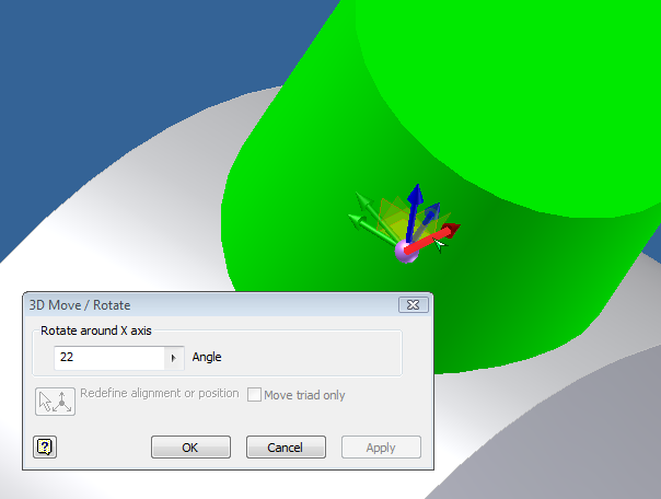

kencaz Posted March 11, 2010 Share Posted March 11, 2010 To rotate using the Triad you simply click on the axis you want to rotate about: Click on the X axis (RED) and you will be given a precise angle input dialog box. KC Quote Link to comment Share on other sites More sharing options...

vertical horizons Posted March 11, 2010 Author Share Posted March 11, 2010 I am attempting to duplicate what you have shown me. While in a .ipt setup, I right click on the extrusion. Then I select MOVE FEATURE. This brings up the 3 D MOVE / ROTATE dialog box. (Is this the way you get to the rotation command?) When I click on one of the axis, & then enter a degree value, the axis shows me a ghost image of where the axis will be, according to what degree I have entered. However, once I click OK, the object does not rotate. I have tried selecting different axis. Quote Link to comment Share on other sites More sharing options...
kencaz Posted March 11, 2010 Share Posted March 11, 2010 Make sure you don't have "Move Triad Only" checked... Quote Link to comment Share on other sites More sharing options...
vertical horizons Posted March 11, 2010 Author Share Posted March 11, 2010 On your last video, it doesn't show how you are getting to the rotate command. Your cursor goes off of the screen. I notice that, once you enter a value, you get a ghost image showing where your object will be rotated to. I don't get the ghost image of my object. I only get a ghost image of the triad. I appreciate your patience with me. Quote Link to comment Share on other sites More sharing options...
shift1313 Posted March 11, 2010 Share Posted March 11, 2010 Does your part have any constraints applied to it that would stop it from achieving this new position? When you are on the move/rotate 3d pop up there is an option to Move Triad Only, make sure this is not what you are doing. Quote Link to comment Share on other sites More sharing options...
kencaz Posted March 11, 2010 Share Posted March 11, 2010 Does your part have any constraints applied to it that would stop it from achieving this new position? When you are on the move/rotate 3d pop up there is an option to Move Triad Only, make sure this is not what you are doing. You could be right Shift. I would say that if it's an assembly (.iam) then possibly trying to move a grounded part, however, OP states he is current file is (.ipt), so it's possible that his invetor options are set to "Never Relax Constraints" or Prompt. KC Quote Link to comment Share on other sites More sharing options...

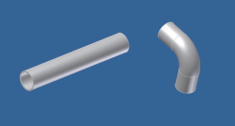

vertical horizons Posted March 21, 2010 Author Share Posted March 21, 2010 ...Do you have a model or screen shots we can look at? Here is a basic drawing of what I am attempting to do. Very basic, but if I can understand how to make an exact degree of rotation here, then I should be able to rotate other objects, as well. The 2" pipe is already at the proper rotation with the upper portion of the elbow. But what if I wanted to rotate the pipe exactly 90 degrees, so that it was lined up to match the angle of the lower part of the elbow? I know that, in this case, I could just RIGHT-CLICK, and use the "CONSTRAINT" Option, but that won't help me to understand about the rotation. Therefore, how would you ROTATE this? I have looked in the tree on the left side of the page. I do not see where I have an option to enter EXACT degrees of rotation. ************** I do not know how to upload an .IAM or an .IPT to this forum, so I uploaded PDFs instead. (I'm sure that this won't be of any help.) What is the procedure for uploading files from Inventor? Pipe 2 Inch 12 & Elbow 2 Inch are .IPTs, and Rotation Test is an .IAM. Rotation Test.pdf Pipe 2 Inch 12.pdf Elbow 2 Inch.pdf Quote Link to comment Share on other sites More sharing options...
shift1313 Posted March 21, 2010 Share Posted March 21, 2010 Well I cant see any reason you would need to rotate it, especially when you are trying to line it up with another object, BUT here is a way you can do it. Select the part you wish to rotate and enter Edit mode. On your Modify tab you have an option that says Move Body. Inside Move Body next to your selected body there is a drop down box. The bottom option is rotate about a line. This line can be one of your axis(y in my case) or a line you select. From there you can enter an angle to rotate and apply it. Quote Link to comment Share on other sites More sharing options...

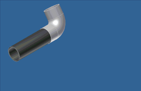

kencaz Posted March 21, 2010 Share Posted March 21, 2010 OK, now we can see what your attempting. In the case of an assembly you'll want to enter an angle constraint instead of rotating as you would in a part file. Here, I already put an insert constraint on the pipe and the elbow to line them up. Then to precisely rotate the elbow chose an angle constraint on the pipe then a perpendicular axis, (x in this case), and enter your rotation angle as such: Also, if you insert the elbow first it may be grounded so check for the pin in your browser... KC Quote Link to comment Share on other sites More sharing options...
