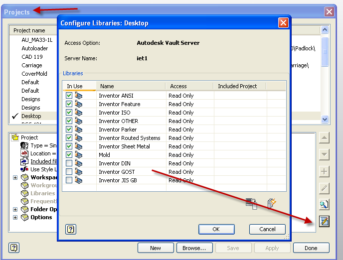

Two ways
in your Project set the libraries you want in Content Center.
I just noticed that on the student community forum that you did not download the additional Content Center libraries. When you ask a question you should include all of the relevant information.
You should see a link on the student community Downloads page to download the additional Content Center libraries. (the student download initially only includes the ISO libraries)
