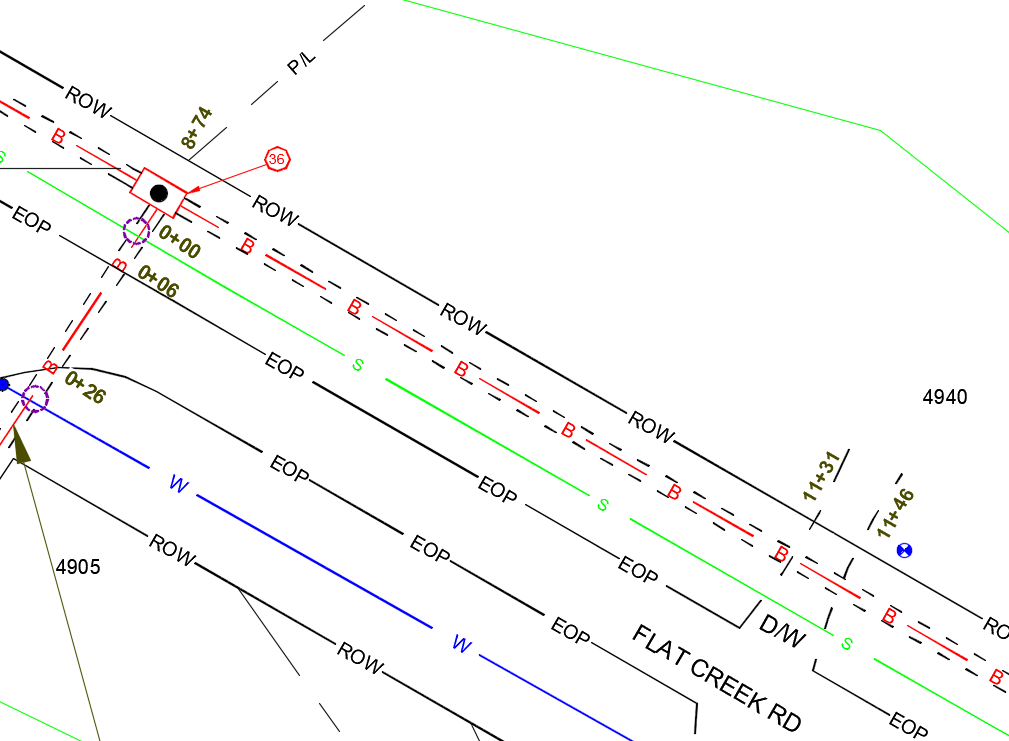

IF a mtext is in (0+00) format, how addition and subtraction of some particular value will change selected mtext in that format{required for station marking } {eg. if A station marking is 5+47 and I want to add 50' with it, it will change to 5+97...and lisp should continue to change of selecting mtext until stop) mtext should not change its layer and color after the addition and subtraction
station marking example:  are in mtext formatimage.thumb.png.25188762bcea3b675f35b603f3eb0fd6.png

Need lee-mac string to list so splits 2+47 into (2 47) then add your amount so becomes 2 & 97 then join back into a string 2+97.

You have the split string so convert to say a real and add your offset value, using atof then make a new string using Rtos.
No comments till a dwg supplied.

SRS.dwg Please check
Not sure what happened to this, previously posted or its posted on another forum like forum/autodesk.
