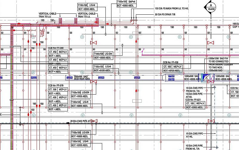

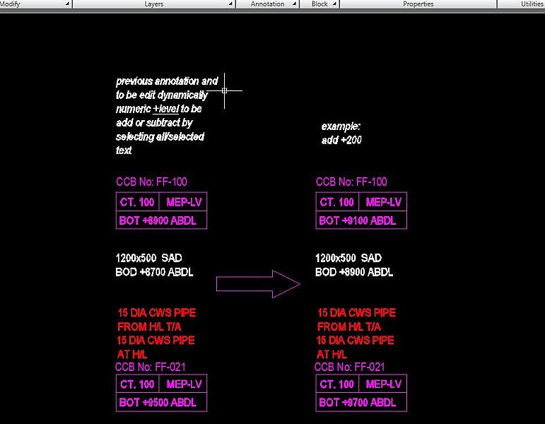

VisDak Posted March 10, 2010 Share Posted March 10, 2010 Hi all, Good day, i have a drawing that all levels of services are indicated, only i have now a problem regarding by revising the levels of annotation, i have to add it by 200mm, of all the levels and all levels will be edit and maybe i'll be missed some of it, if a route cud sellect all or selected the text and choose add or subtract then put the valve to be merge(add or subtract) on numeric annotation, and it will be easier and safe, please see image for other clarifications many thanks, Quote Link to comment Share on other sites More sharing options...
Lee Mac Posted March 10, 2010 Share Posted March 10, 2010 Try this VisDak: (defun c:Text_Inc (/ *error* ParseNumbers uFlag ss) (vl-load-com) ;; Lee Mac ~ 10.03.10 (defun *error* (msg) (setvar 'NOMUTT 0) (and uFlag (vla-EndUndoMark *doc)) (or (wcmatch (strcase msg) "*BREAK,*CANCEL*,*EXIT*") (princ (strcat "\n** Error: " msg " **"))) (princ)) (defun ParseNumbers (str / lst Num Aph x rtn) ;; Lee Mac ~ 20.09.09 (setq lst (vl-string->list str) Num "" Aph "") (while (setq x (car lst)) (setq lst (cdr lst)) (cond ( (and (/= "" Num) (= 46 x)) (setq Num (strcat Num (chr x)))) ( (< 47 x 58) (setq Num (strcat Num (chr x)) rtn (cons Aph rtn) Aph "")) (t (setq Aph (strcat Aph (chr x)) rtn (cons (read Num) rtn) Num "")))) (vl-remove nil (vl-remove "" (reverse (cons Aph (cons (read Num) rtn)))))) (setq *inc* (cond (*inc*) (1.0))) (setq *inc* (cond ((getreal (strcat "\nSpecify Increment <" (vl-princ-to-string *inc*) "> : "))) (*inc*))) (setq *doc (cond (*doc) ((vla-get-ActiveDocument (vlax-get-acad-object))))) (setvar 'NOMUTT 1) (princ "\nSelect Text to Increment <All> : ") (if (or (ssget "_:L" '((0 . "MTEXT,TEXT"))) (ssget "_X" '((0 . "MTEXT,TEXT")))) (progn (setq uFlag (not (vla-StartUndoMark *doc))) (vlax-for obj (setq ss (vla-get-ActiveSelectionSet *doc)) (vla-put-TextString obj (apply (function strcat) (mapcar (function (lambda (x) (if (vl-position (type x) '(INT REAL)) (vl-princ-to-string (+ x *inc*)) x))) (ParseNumbers (vla-get-TextString obj)))))) (vla-delete ss) (setq uFlag (vla-EndUndoMark *doc)))) (setvar 'NOMUTT 0) (princ)) Alternatively, I think CAB wrote a good once a while back here. Lee Quote Link to comment Share on other sites More sharing options...
