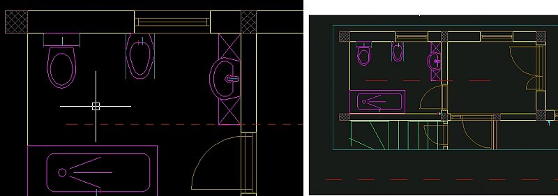

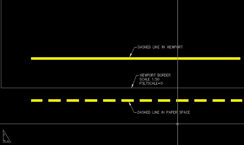

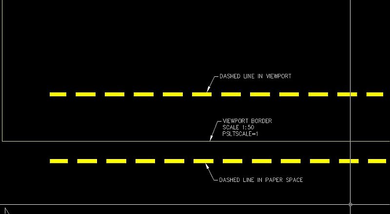

the-trooper Posted March 9, 2010 Posted March 9, 2010 Hello everyone! I have a little problem, have searched forum for answer and proposed solutions do exact the opposite of what i need. Dashed line in question, as you might have guessed. I draw in model space; everything looks fine I set up my layouts with viewports; everything looks fine But now, i need to draw a dashed line on paper space, and that is not fine! ON paper space not in viewports. It’s spacing is much larger, than the ones in viewports. What i found on this forum suggests: MSLTSCALE to 1 But then it looks continuous in model Setting PSLTSCALE to 1 But then it looks continuous in viewports So i set them both back to 0. Seems to me these variables affect only scaling in viewports but not on the paper space itself. What am i missing? Here is a one and a half minute video so you can see just what i’m talking about, and what i need it to look like. Layer with red, dashed lines in question. http://www.box.net/shared/15u80blaqb Oh, LTSCALE, always 1. Thanks in advance! Quote
lpseifert Posted March 9, 2010 Posted March 9, 2010 When Msltscale is set to 1 the linetypes display at the Cannoscale setting in Model Space on the Model tab- When Psltscale is set to 1 the linetypes display at the Viewport scale setting in the viewports. BTW... the Psltscale is not global, if edited it must be done per Layout tab Quote

the-trooper Posted March 10, 2010 Author Posted March 10, 2010 Half way there! You are right lpseifert, it's a scaling problem! I work in metric, in centimeters. When started to work i just created my title blocks in centimeters, when plotting from layouts set plot scale to 1:0.1, and plotted result looked OK. But i see the wrongness of my way Now i created new rectangle for A4 in millimeters and new scales, for 1:100 – 1 paper unit = 10 drawing units; for 1:50 – 1 paper unit = 5 drawing units. That sorted out my scales. Oh man, i'll have to go through all my annotative stuff, text styles, dim styles… Damn... But, now i have a new problem. Spacing of lines in layouts, and on paper space, is bigger than in model space. Any way off forcing them to show the same spacing as in model space? Dwg attached. MSPSScaling-2-2007.dwg Quote

the-trooper Posted March 10, 2010 Author Posted March 10, 2010 Damn... See that picture i attached above, definitely not the same... Quote
