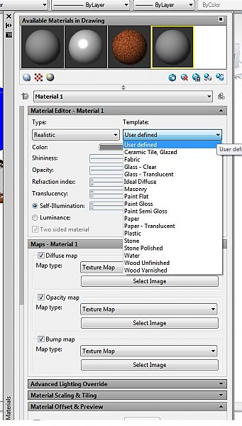

Bowl.Spliffson Posted April 24, 2009 Posted April 24, 2009 Is there anyone out there that could help me draw a mirror in 2009. Rmat doesn't seem to exist anymore Quote
shift1313 Posted April 24, 2009 Posted April 24, 2009 i dont have a screen shot handy but im pretty sure there is a mirror template built in. when you create a new material can you take a screen shot of what templates are available? Quote

Bowl.Spliffson Posted April 24, 2009 Posted April 24, 2009 Here's the screen shot. I tried messing around with the two different glass templates it has but I couldn't get it to look reflective. I see why you called that one the joker bathroom haha Quote
shift1313 Posted April 24, 2009 Posted April 24, 2009 okay under the Type menu there should be at least 4 options if i remember right. Realistic, Realistic metal, advanced, advanced metal. Try going to the realistic metal . You want the shininess all the way up and the self illumination all the way down for starters and see where that gets you. Quote
