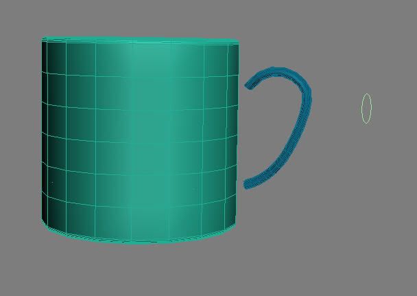

resting Posted March 6, 2010 Posted March 6, 2010 I was following a tutorial for a mug. But it uses hinge to create the handle while I choose to use loft. Problem now is, I have this handle and the body. How do I join them together? Quote
Cad64 Posted March 6, 2010 Posted March 6, 2010 That won't be a very easy task because the mug has very low resolution and the handle has very high resolution. It will be very difficult to join these two objects successfully. You should probably go back and follow the tutorial. I'm sure they probably Turbosmooth the whole thing when they get finished which will smooth everything out. Which tutorial are you following? Quote
resting Posted March 6, 2010 Author Posted March 6, 2010 hi thanks for the quick reply. I'd just changed the shape of the handle. The tutorial is from my school's text. Is the resolution the problem? So can I prolly reduce the segments for the handle or increase the one for the body to make it easier? I don't know man..totally clueless how to join them. The tutorial used hinge to form the shape of the handle and then used "Bridge" to join the opening at the bottom. I think it works because they are one entity. For my case its 2 different entities. Quote
Cad64 Posted March 6, 2010 Posted March 6, 2010 I think it works because they are one entity. For my case its 2 different entities. Select the mug and then, in the Modify panel, click the "Attach" button. This will combine the two objects into one, but you will still have trouble joining the handle to the mug unless you reduce the handle resolution down to 4 sides. You might want to increase the diameter as well. Once you have a 4 sided handle you can try joining it using Bridge. If that doesn't work, you could try Boolean. And if that doesn't work, you will just have to manually create polygons to bridge the gap between the two objects. Quote

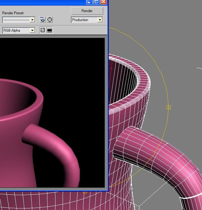

resting Posted March 6, 2010 Author Posted March 6, 2010 Actually no. And I'm cursing them for setting questions where no answers could be found. I've kind of joined the 2 object together with the union tool. Is there a way to make the connecting edge nicer? I cheated on this one by moving the handle into in body. And the result of cheating is a ugly outline. I could do a bridge now that the 2 objects are one. But the result looks worse. I think its the resolution thing that you're saying causing the problem. The handle doesn't fit nicely for a bridge. Quote

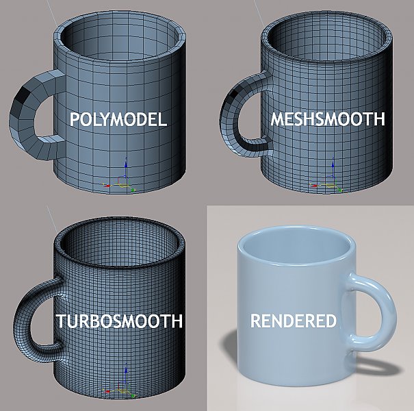

Cad64 Posted March 6, 2010 Posted March 6, 2010 See, that's what I was trying to tell you about making the handle square. The handle needs to have the same number of polys as the cup that it will be joined with. Take a look at the image below. I created the model, applied a meshsmooth and then a turbosmooth and rendered it. Notice the nice transition between the cup and the handle. Quote

Cad64 Posted March 7, 2010 Posted March 7, 2010 If I were you I would start over and model the cup similar to the one I did. Leave it kind of blocky and low res. If you want the cup to have a curve to it, that's ok. When you apply the smooth modifiers, they will smooth and blend everything together. Just be sure to make the handle square so that it will plug into the cup in the same manner as the one I did. What you were trying to do was plug a round handle into a square hole, and that just won't work. Quote
resting Posted March 7, 2010 Author Posted March 7, 2010 i dumped the handle and did a square 1. also lowered the body segments. then i did a connect command to join the 2 together (after adjusting the handle to the body). still it doesn't fit perfectly (lazy to rework) but I think its good enough. thanks for the help else I'd still be stuck and end up with nothing to show. now...to deal with those theory questions where no answers could be found...argh.. Quote
