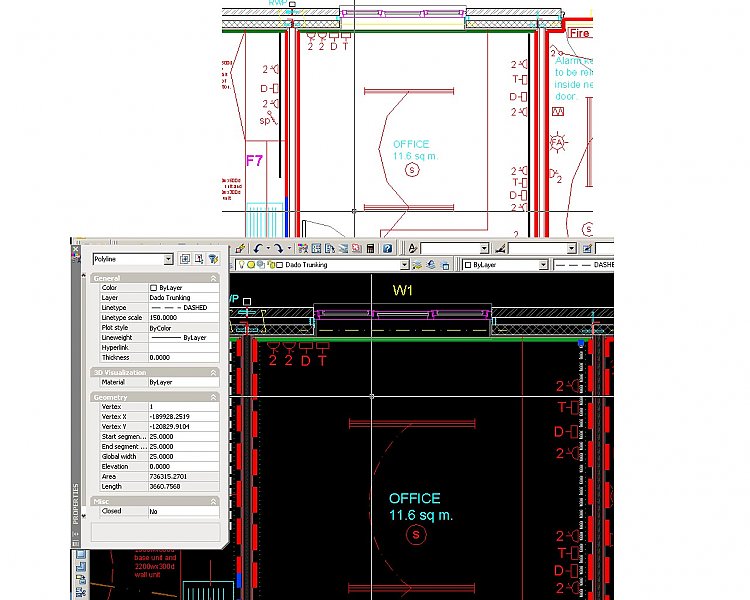

sparkyuk Posted March 4, 2010 Share Posted March 4, 2010 Got a hard copy of a drawing through the post and the dado trunking shows up as a dashed line, but when i try to print from the cad drawing that they sent me they come out a solid, now in model space these line are white dashed a per my pics attached but in paper space they are black solid lines, can anyone explain why this is please?. If it helps im not so sure that this cad was drawn using auto cad as when i opened it all the isulation layers etc are well over sized to the drawing if thats a clue ? edit just notice all the dashed lines in model space are solid in paper space Quote Link to comment Share on other sites More sharing options...
TheCan Posted March 4, 2010 Share Posted March 4, 2010 Hi! Try to change PSLTSCALE to 0. Quote Link to comment Share on other sites More sharing options...
sparkyuk Posted March 4, 2010 Author Share Posted March 4, 2010 Thanks TheCan that sorted it, any ideas why it defaulted to 1 ? Quote Link to comment Share on other sites More sharing options...
nancysb Posted March 19, 2010 Share Posted March 19, 2010 DASHED LINES ARE SOLID IN VIEWPORT! I've tried the suggestions from sparkyuk dated 4th March, 2010, but it doesn't work. I've set the PSLTSCALE to 1 (and to 0) and LTSCALE to 1 I've gone into the Linetype Manager and made sure hat all the dashed lines did not have "use paper space" checked. I don't know what else to do. My dashed lines will not show up as dashed in my viewports or when Iplot! Thanks. Quote Link to comment Share on other sites More sharing options...

kencaz Posted March 20, 2010 Share Posted March 20, 2010 DASHED LINES ARE SOLID IN VIEWPORT! I've tried the suggestions from sparkyuk dated 4th March, 2010, but it doesn't work. I've set the PSLTSCALE to 1 (and to 0) and LTSCALE to 1 I've gone into the Linetype Manager and made sure hat all the dashed lines did not have "use paper space" checked. I don't know what else to do. My dashed lines will not show up as dashed in my viewports or when Iplot! Thanks. Make sure your regen or you wont see the changes. KC Quote Link to comment Share on other sites More sharing options...
MikeScott Posted March 20, 2010 Share Posted March 20, 2010 Use your properties window, select the dashed line, and change the linetype scale up and down, regenerating between changes.. Quote Link to comment Share on other sites More sharing options...
nancysb Posted March 20, 2010 Share Posted March 20, 2010 Kencaz, Thanks for your beautiful animation! I've tried this, and I still don't have dashed lines in my viewports, only in my Model. I've even tried setting the scale to ). NOthing works...(so far) Quote Link to comment Share on other sites More sharing options...
nancysb Posted March 20, 2010 Share Posted March 20, 2010 Mike Scott, Thanks, I"ve tried your suggestion as well (set the line all the way from 0 to 3!), regen all, and it still doesn't work. Quote Link to comment Share on other sites More sharing options...
MikeScott Posted March 21, 2010 Share Posted March 21, 2010 Try values like .125 .5 .75 etc.. Setting the psltscale value to 1 From Cad 2006 help: Controls paper space linetype scaling. 0 No special linetype scaling. Linetype dash lengths are based on the drawing units of the space (model or paper) in which the objects were created. Scaled by the global LTSCALE factor. 1 Viewport scaling governs linetype scaling. If TILEMODE is set to 0, dash lengths are based on paper space drawing units, even for objects in model space. In this mode, viewports can have varying magnifications, yet display linetypes identically. For a specific linetype, the dash lengths of a line in a viewport are the same as the dash lengths of a line in paper space. You can still control the dash lengths with LTSCALE When you change PSLTSCALE or use a command such as ZOOM with PSLTSCALE set to 1, objects in viewports are not automatically regenerated with the new linetype scale. Use the REGEN or REGENALL command to update the linetype scales in each viewport. Quote Link to comment Share on other sites More sharing options...
