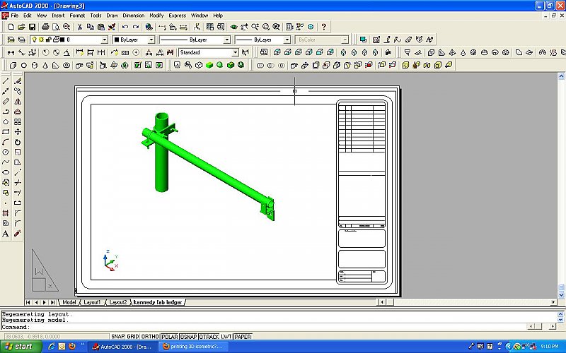

I'm using autocad 2000 and I need to print my 3D model with my layout template. When I copy my 3D object from the model page and try and post it to my layout, it shows up as a top view, 2D wire frame. I need to be able to print it as a 3D isometric. help please
Why would you copy your 3D object from model space and put it in your layout?
Create a viewport in your layout. It is the viewport that allows us to see the objects we have created back in model space. It doesn't matter if those objects are 2D or 3D.

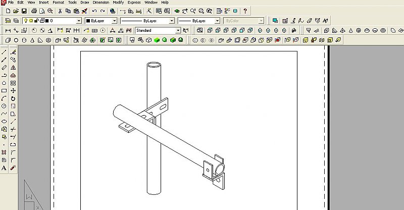

I would only do that cause that's what I do with my 2D objects. I've never drawn anything in 3D, only a 2D in isometric. That would work perfectly in this situation except that I need to include a u-bolt in iso and I can't seem to make it work. This is what I'm working with. I really need it to be an outline. Any ideas on drawing a u-bolt in 2D iso?
An outline? Do you mean a wireframe?
The image below is an actual screen shot of a layout. Two viewports were created. In the viewport on the left we have a pipe support detail; visual style = conceptual. In the viewport on the right we have an enlargement of the pipe clamp; visual style = 2D wireframe.
Is this what you are trying to do?
I must apologize for the drawing. It was one of my earliest attempts at 3D and I got some things wrong. I use it here primarily because the "U" clamp is kind of like a U-bolt.
This is basically what I'm trying to get to, only with u-bolts added. I drew this in 2D iso. I know this is the same as a 3D Hidden but the u-bolts don't look right in hidden. I would use wire frame but there are too many lines and I can't seem to remove some of them without losing the part.
Ok then...add the U-bolts. I don't see what the problem is at this point.
I was able to do it by offsetting my iso circle and modifying it to make a u-bolt. I'm not sure but there has to be an easier way to do it. thanks for your help on the 3D.
A U-bolt can be constructed in 3D by drawing the centerline of the bolt and then extruding a circle along this "path". You're using 2000 that's why I did not suggest using the sweep command.
