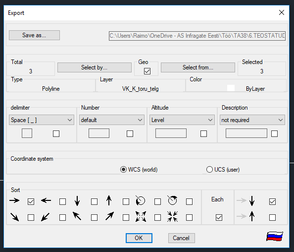

Is it possible to add a blank line to each polyline in the output file?
At the moment the result file:
1 6465208.7146 658834.6419 0
2 6465216.9891 658834.7200 0
3 6465232.4292 658846.1043 0
4 6465235.9962 658907.4005 0
5 6465239.6593 658968.5181 0
6 6465216.6301 659002.7412 0
7 6465236.6919 658957.7839 0
8 6465239.9847 658960.6938 0
9 6465207.1595 658842.8381 0
10 6465207.2492 658844.1545 0
11 6465232.4292 658846.1043 0
I would like the result to be the like this
Picture on the settings I used
Also attached used dwg file
Sample file.dwg
