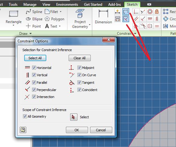

Thanks for the tip on projecting axis on sketck plane never thought of using that one and i have only been working with inventor for 4 years. I am also having trouble with drawing lines from projected center point, it will not give me a automatic vertical or horizontial from drawing off center point (eg line turn black drawing of Center Point). This has worked fine for many years but now is playing up and annoying when you have to manually add vert/horz constraint. I think the both problems are related and may be just a setting but can not find.

As far as your settings go. Up on the ribbon where your constraint buttons are there are two buttons. They are constraint inference and persistance. This can also be controlled with the CTRL button while sketching. To change which constraints these apply to, in a sketch with nothing selected, right click. The menu should have a Constraint Options listed. That will pop up the window you see in the image below.

Thanks Shift1313 the constraint thing worked perfect. Back to normal. As for the flanges unfortunately inventor doesn’t have a lot of Australian Standards in the library. i dont have a ribbon is that new to inventor 2010? i tried it on autocad did like it much.
