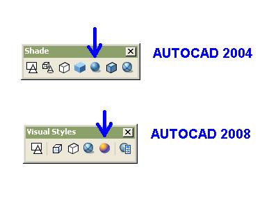

I need to revise some of my old drawings, They're made by using Autocad 2004. The solid parts are set to gouraud shaded with index color 254.

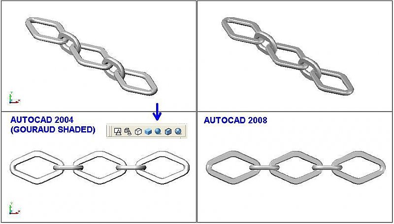

The problem is, when I reopen it by Autocad 2008 the solid part looks darker than by Autocad 2004. I checked the index color and it's still 254.
The questions are,
1. What causes it? although I didn't change the setting.
2. Is there an option setting for gourauded shaded at Autocad 2004?
3. If there is,
where do I find it? so I can change my visual styles at Autocad 2008
accordance to Autocad 2004.
Thank you for help!

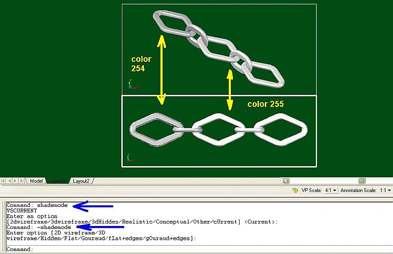

Are you looking for -shademode (be sure to include the - sign)
Yes, I want to set my drawing "Autocad 2008" to -shade mode (gouraud shaded), but there's no -shademode on it but only visual styles manager.

Actually I want to get silver color.

I think I got your point now JD Mather.
The different between shademode and -shademode, it's simple but a big deal.
Even though my solids are still darker than at Autocad 2004 but now I change the color index from 254 to 255. At least it's solve my problem for now.
