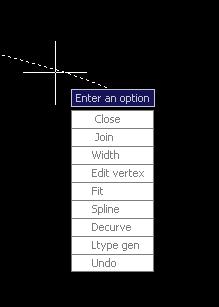

I want to share a code I found in theswamp.org
Request: Hi is it possible to get in lisp the menu like in pedit command? see atach.
Reply: yep the [ ... ] does the trick
(initget "Left Right Up Down Sideways Insideout Forwatd Backwards")
 (setq direction
        (getkword
          "\nElbow direction [Left/Right/Up/Down/Sideways/Insideout/Forward/Backwards ] <Right>: "
to have the prompt display
you will need the
DYNMODE variable set to 1, 2, or 3
and
DYNPROMPT variable set to 1
