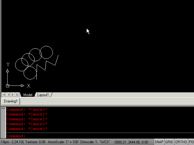

Something I was playing around with a while back. I use it form time to time. Made a little update yesterday and thought I'd add it here.
Will allow you to select a group of objects and store them for later copying. This objects are stored in a global variable and do not have anything to do with the Clipboard. Once you store the objects, you can continue performing any normal functions and when you are ready to have those stored objects to place somewhere else, just execute the command.
Call with Copystored or CS
Sorry for the choppy video, I had to cut the frames to keep file size down (not sure what's going on with Camtasia).
i got same problem everytime i use that software before
Generally, it will stay under 250k, but I couldn't get it below 400 on this one.
