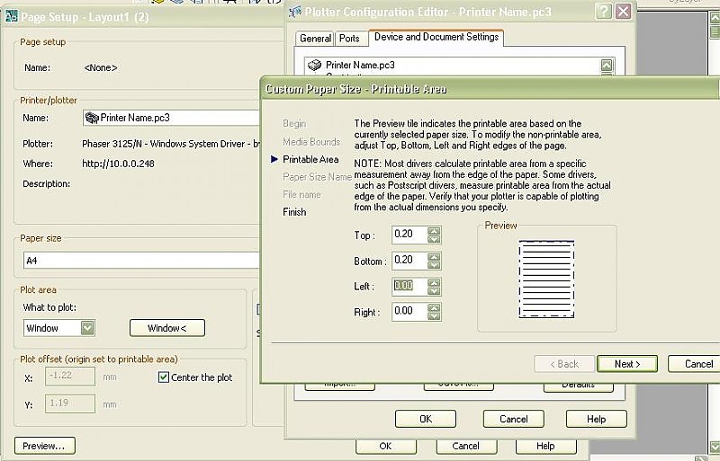

ica_cici Posted February 23, 2010 Posted February 23, 2010 Is there anyone know a tutorial about setting printable area?. I am using a new printer now (Xerox Phaser 3125N), and set the printable area same as the old printer (canon IP800). The problem is my drawing doesn't come out all when I plot, even I use same margin as the old printer. Is there a way to fix the printable area so I can use it with different printer? Thanks for help! Quote

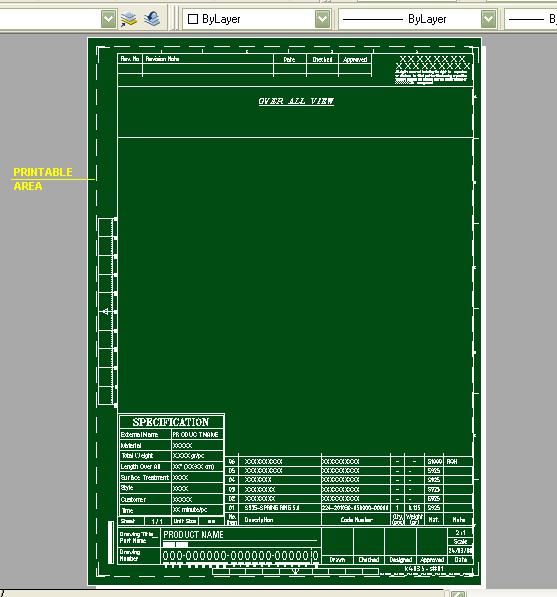

ica_cici Posted February 24, 2010 Author Posted February 24, 2010 Yes, I always plot drawing in paper layout using plot scale 1:1, window for the plot area, and center the plot for plot offset. I even set printable area to 0.00 for the left & right margins. The plot preview is fine, I have my drawing full appears but when plot it part of drawing at the left and right doesn't come out. Does it means that those are the maximum printable area and the minimum "hard clip" area of the plotter? And for the Plot Offset, Is it based on ucs origin or just the plot area? (X & Y value). Should I set the ucs origin to 0.0? From the custom Paper Size-Printable Area there's a note says (most drivers calculate printable area from a specific measurement away from the edge of paper. Some drivers measure printable area from the actual edge of paper. Verify that your plotter is capable of plotting from the actual dimension you specify.) Where I should look for to verify that my plotter is capable for it? Thanks for help! Quote
ReMark Posted February 24, 2010 Posted February 24, 2010 Are you plotting to scale or not? If you aren't then it shouldn't make a difference. If you are then turn OFF the Center the plot option and enter a plot offset for both X and Y. And why are you even going into custom paper size? Are you really using a custom sized sheet? If so, what size exactly? Quote
ica_cici Posted February 25, 2010 Author Posted February 25, 2010 No, I am not. I always use scale 1:1 when plotting. I use A4 paper, but my template is bigger than the printable area that's why I use custom paper to change the printable area. Should I change my template? Quote

BIGAL Posted March 2, 2010 Posted March 2, 2010 I think your still missing the point that people are saying here your template is bigger than the printable area ! 210-202 is 8mm I am pretty sure our HP printer has a hard clip of 5mm each side thats 10mm so either 1 side would print or if centered neither edge line would print. Measure carefully what is printing this is the hard plot limit. Quote
ica_cici Posted March 2, 2010 Author Posted March 2, 2010 Yes, you're right. I Resized my template to be 200 X 284 and I got full drawing now. Thank you. Quote
