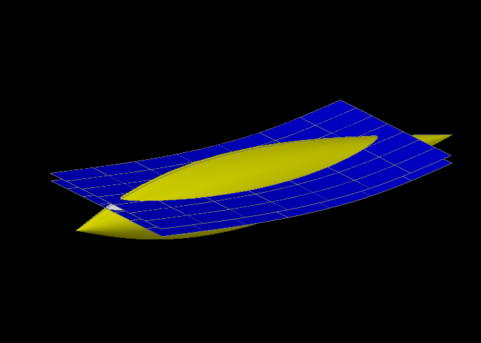

An easy way is to start with a profile of the of the contour you want, (using splines or arcs), and revolve it.
Then, draw your rocker profile perpendicular. to the contour... , and extrude the lines into surfaces.
Use slice with the surface option to cut the rocker profile, and remove the waste.

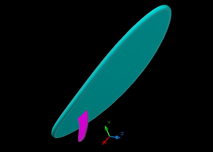

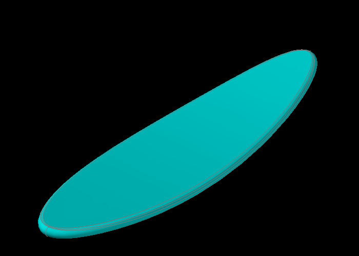

Fillet the edges to round the nose and rails.
Add a fin and your fin...

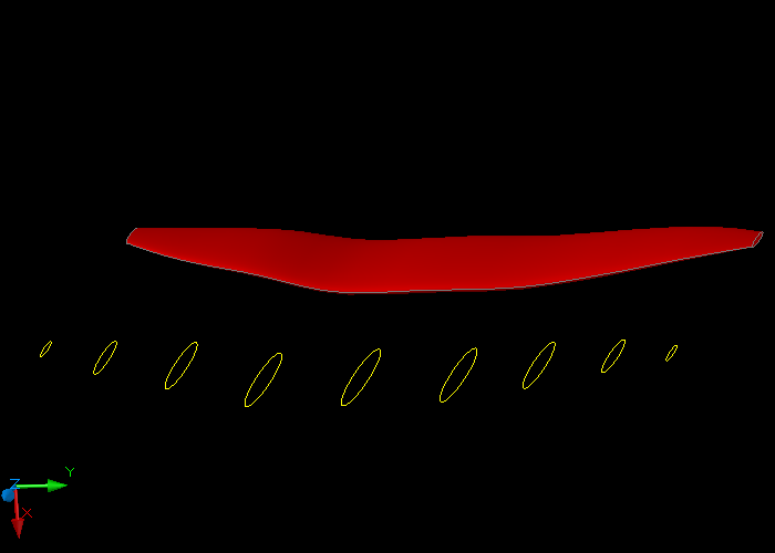

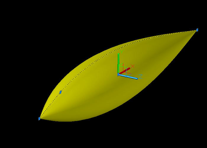

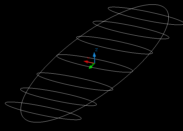

Most likely then a loft would be your best option. Create your boards edge-on profile. Copy or array the sections to be lofted. Draw the boards plan profile perpendicular to the lofted sections.
Scale the lofted sections to the plan profile using the reference option.
Now offset the profiles to the desired bend of the board and loft the sections. I exaggerated the offsets a bit.
I used simple ellipses but you can copy the profile from your last post above and it will work the same.
