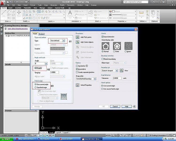

ruksi Posted February 24, 2010 Share Posted February 24, 2010 You can do hatch patten user defined It can change as per the my attach jpeg no 01 Then you can see horizontal way line for change that as per no 02 tick then you can give the spacing as tile size, no 03 use for adjust cut tile I hope this ok for you Quote Link to comment Share on other sites More sharing options...

hugha Posted February 25, 2010 Share Posted February 25, 2010 ... use the Hatch Origin options in the Hatch and Gradient dialog box. Quote Link to comment Share on other sites More sharing options...

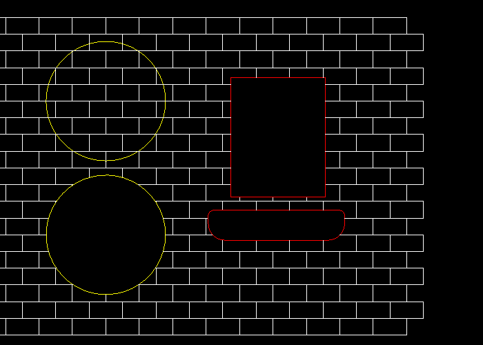

kencaz Posted February 25, 2010 Share Posted February 25, 2010 hi thanks, will try the array command although i'm using a brick pattern so not sure if this will work, will keep you posted.... Why couldn't you array a brick pattern? For such a small area and I would just array a brick pattern making your tiles the size you want to purchase. This will avoid having to scale the hatch pattern and having to insert your fixtures before hand to hatch around them with regions and islands... You can then array the whole section of wall you want to tile and insert your wall fixtures and windows no matter what the shape and just trim. KC Quote Link to comment Share on other sites More sharing options...
Crazy J Posted February 25, 2010 Share Posted February 25, 2010 Following on kencaz's idea.... so you would just create your brick pattern in such a way that when repeated via an array, you get a full brick look? The attachment here is an example unit of the brick pattern that could be arrayed. I guess you would have to play around with which centerline of the brick pattern you chose for each corner of the unit based upon how you plan to lay the brick based upon the shape of the room and such. Quote Link to comment Share on other sites More sharing options...
