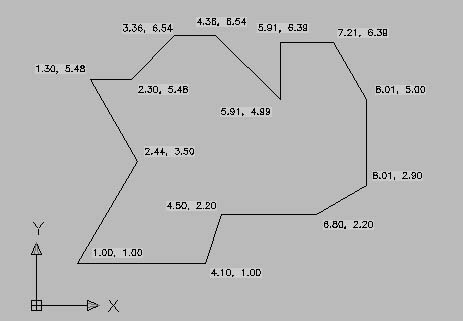

TYGA Posted February 20, 2010 Posted February 20, 2010 Hello everyone, I'm having a problem with showing the both x,y coordinates for a certain point , does anyone know how can i do that:cry: , and by the way I'm using Auto-CAD 2005, because whenever i try to show it , it either show the X - coordinate:wink: or the y - coordinate:wink: alone but i need to show both of them:( for example this point (4.2 , 2.2). thank you guy's for the wonderful forum , and please accept me as a new friend. Quote

TYGA Posted February 21, 2010 Author Posted February 21, 2010 i'm looking for an easy way to put the coordinates pf the point on the draw ( not the text one:glare:) like those > Quote
TYGA Posted February 21, 2010 Author Posted February 21, 2010 eldon , your way is nice but i think it's too complicated for a beginner. I know this way ( Dimensions>Ordinate>RightClick on the Point>.X or .Y ) but as you can see it will give one coordinate for to the selected point , Either X Either Y ( and that doesn't work with me ) , So Any Ideas. Quote
eldon Posted February 21, 2010 Posted February 21, 2010 All beginners have to start somewhere, and having an object in sight is very motivating. Either you have to master using Lisps or you have to master using Fields. I usually use r 2002 which does not have Fields, but managed to generate the picture above quite quickly using 2005. Go for it! Quote

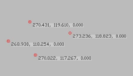

lpseifert Posted February 21, 2010 Posted February 21, 2010 As eldon suggested, make a block with Fields. I'm attaching an example I created a while ago to label Northings, Eastings. I saved it in 2004 format, hope it works for you. ACAD-Drawing1.dwg Quote
eldon Posted February 21, 2010 Posted February 21, 2010 I made a block which was a point, and then inserted a field of its position (x,y). Then it can be inserted or copied to each end point in your drawing. Then reformat the point to be a dot, and you cannot see it any more! The text can be dragged around with the grip to be where you want it. If you want to go further, then you can explode all the fields, then you will be left with text only. Quote
paulmcz Posted February 21, 2010 Posted February 21, 2010 Either you have to master using Lisps ..... A leader lisp that does what you want -> (defun c:31 (/ odt odg oecho oerr p1 p2 a1 a2 a) (setq odt (getvar "dimtad") odg (getvar "dimgap") oecho (getvar "cmdecho") ) (setq oerr *error*) (defun *error* (msg) (princ "\n ERROR!") (setvar "cmdecho" oecho) (setvar "dimtad" odt) (setvar "dimgap" odg) (setq *error* oerr) (command) (princ) ) (setvar "cmdecho" 0) (setvar "dimtad" 0) (setvar "dimgap" -0.09) (while (setq p1 (getpoint "\n Point to identify: ")) (setq p2 (getpoint p1 "\n Place annotation: ") a1 (rtos (nth 0 p1) 2 1) a2 (rtos (nth 1 p1) 2 1) a3 (rtos (nth 2 p1) 2 1) ;;a (strcat a1 ", " a2 ", z=" a3) a (strcat a1 ", " a2) ;;a (strcat "x=" a1 "\\Py=" a2) ;;a (strcat "x=" a1 "\\Py=" a2 "\\Pz=" a3) ;;a (strcat "x = " a1 ", y = " a2) ) ;(if (/= a3 "0.000")(setq a (strcat a1 ", " a2 ", z=" a3))) (command "leader" p1 p2 "" a "" ^c) ) (setvar "cmdecho" oecho) (setvar "dimtad" odt) (setvar "dimgap" odg) (princ) ) ;_ end of defun (prompt "\n To start ID Leader, type > 31 <: ") Quote
edwinprakoso Posted February 22, 2010 Posted February 22, 2010 I wrote a tutorial about labeling coordinate with field. I hope it helps. Quote
